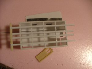

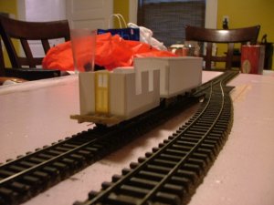

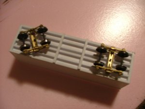

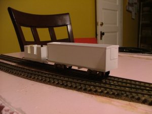

I've only done a little more on the 900 series boxcar for now. I'm going to add a roof, door details, and grab irons too. I just picked up some lead weights today to add to the car. I also mounted some Precision scale trucks under it for now, as I don't feel like purchase the right trucks now (the PSC trucks I've had for a few years).
Instead, I've been working on an 1882 DSP&P waycar (caboose) to go along with it. The waycars of 1882 were 13' long. All were built without cupolas...but received them between the 1890's and 1910's Mine has 1 resin endsill and 1 resin door so far. I'm going to cast another of each...and probably build the windows in-situ. I was delayed in the work until I picked up the lead weight today. It will eventually have an interior. Two of the waycars survive in their modern configuration...1006 at Silver Plume, Co (which would originally have been identical to my car) and the 1009 which was a 14'10" car (which is similar to earlier DSP&P waycars).
