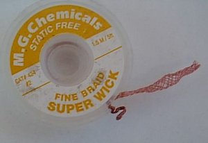

Neophyte here...WHAT is a solder wick?? I mean it's obviously used to 'wick' away molten solder, but what material and size and shape is it?

Solder wick is flat braided copper strands. It comes on a spool. The small size is about 1/8" wide. It one of the few things still worth a hoot that you can get at Radio Shack..LOL:D
If I can find something on a tutorial I'll post it here.
Vic..Thanks!! Hmmmm... braided copper wire strands, I can see how that would work nice. Thanks for the link, that should give me the basics.
