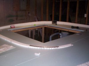

13Mtrainer said:
i was woundering how you guys here make grades. i am putting one on my layout and dont really know how to make one. i was going to make little trusses (spelling?) out of tooth pick. but i need other ideas. please post some pics of your grades so i may learn. also explane them.
thanks in advance 13Mt.:)
this is how i am making mine its woodlands secnics foam risers system the one in the pic is the 2% grade one part of the risers is 16 feet long so the hole thing you see is 24 feet long end to end and at the top of the grade its 4" high
they make a 3% and a 4 % also the 4% is 8"feet long so with the up and down it would be 16 feet in all . and remember to buy two one to go up and one to come down
