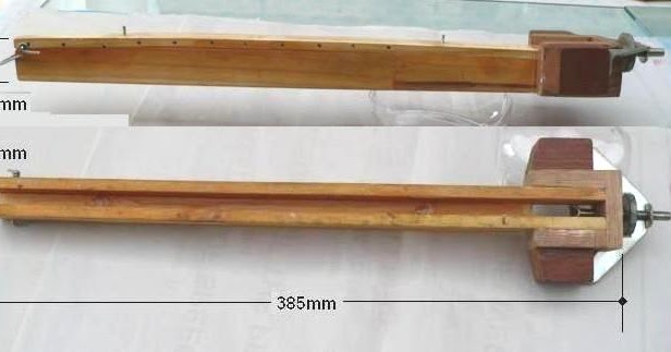

I don't remember where I got it, but I use the attached PDF. It was free (I do remember that)
  • px49-railing-and-ladder-template.pdf

the little template is for making ladders, and the long one is for the railings
