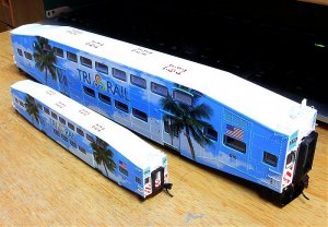

I got my Athearn Tri-Rail in both HO and N scale a couple of weeks ago. I noticed my HO Scale coaches coupler height is high compared to my other locos and wagons. Also noticed the couplers are made by Bachmann. I thought they come installed with McHenry couplers.
How can i fix the coupler height? What is the correct height set by NMRA? Need to get one of those NMRA tools.

Dark curves, to check your coupler height, you can use an NMRA gauge, but I think a Kaddee coupler height gauge is a better choice. I have an 18 inch long 1x4 board with a coupler height gauge fastened down to each end of the section of track. That way, I can put a car or locomotive on the track and check both ends without having to turn the locomotive or car around. It not only checks coupler height, but also checks the uncoupling "hose" for the correct height. Just one caution, don't try to power up the track to try to use the power to move a locomotive. The Kaddee gauge is steel and will cause a direct short circuit.
