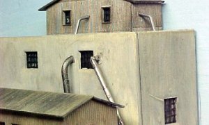

Here's one I just picked up the other day...
I was looking through my scrap box for windows to use on my scratchbuilt N scale flour mill, & couldn't find anything that suited me.
While scrounging around in the basement, I found some of this plastic mesh tape used for joining sections of drywall (sheetrock)
Drew1125
Jan 28, 2001
2,975
I cut a few pieces, & painted them black, & they made pretty decent industrial-type "steel frame" windows.
This stuff is cheap, & one roll could make hundreds of windows!

Now Charlie that is just downright bloody clever.
I have been using a similar cloth type stuff (actually an insect screen that we use on the sides of our tunnel houses) and soaking it in plaster to use for terrain and had even considered using the same stuff you have (bought REAL cheap thru my builder brothers) as an overlay - but would NEVER have seen windows in it - never.
