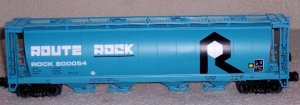

i guess i have never known anything but grain or beans to be carried in hoppers,
Triplex
Aug 24, 2005
1,719
Calgary, Alberta, Canada
Most people would automatically assume an open hopper (for coal, ore, etc) when the word "hopper" is mentioned. I see you were assuming a covered hopper (for grain, sand, etc).
