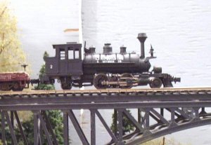

I acquired this fully assembled, and cannot find a manufacturer's name on it. Maybe someone will recognize it, or you might be able to use the picture to find one. Drivers are 36" dia, and overall wheelbase, pilot to trailing, is 18'.
The frame is diecast, and the boiler/cab, plastic.

from a quick google search, this looks like an Erie Limited model imported by sunset back in the mid 80's. Quite interesting and would work perfectly if it were cheaper and still available. This is a long-term project and I have plenty of time to search ebay...
Kevin
