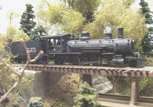

All the finishing work is done, painted,lettered,weathered, and oversprayed with dullcoat. This one's ready for Trainfest. The only unanswered question is how she'll pull through the tight curves.
I'll find that out this weekend.

Hi Pete, Now that looks mighty fine!!!!:) Excellent!!...The lowering really gives those locos an all together different look. Shouldn't be any problems with the curves. Looks like there's plenty of swing where it needs to be. Lemme know how she does. Great job!!!:)

Beautifully done Pete, a work of art. There's no way I would have guessed it started life as an MDC kit.
As Vic says, the lowering makes it look like a real hauler.
One question..... which coupler is fitted on the front?
I could ask a multitude of questions but there is no way I could tackle such a conversion.
Well done sir.

Errol,
Same as the others I've done. Kadee narrow gauge couplers, modified by cutting most of the rear portion of the coupler and draft gear box off, to clear the pilot truck. I didn't intend on using magnetic uncoupling, so the loss of the centering spring is no major deal. I'll just manually align the coupler when switching.

OK, the loco ran all day Saturday, and Sunday, at Trainfest. Had a problem with the pilot wheels shorting out on the screw used to mount the front coupler, but fixed that with a file. It doesn't pull as well as the 2-4-4-2, but then, doesn't have the weight, so is all right.
