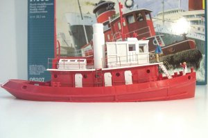

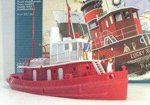

Here's pictures of the Revell "Harbour Tug Boat" kit rebuilt as a 1:87 towboat. The kit box cover is the background. I changed the size of the doors, raised the main deck superstructure about a scale foot. scratched a new pilothouse, stack, and skylight. added railings,and increased the area of the upper deck. The red parts are the original kit. The model is ready to prime coat.

Nice!!!! I've always liked that kit but never see it on shelves anymore. Your modifications are well done!! Will you post pics of how you use the tow boat on your layout?

The kit is 1:108 scale, and some of the details are too small for HO. Could be used in the background very nicely though.

I picked this up my last trip east,in New Jersey. I understand it is/was a re-release. I'm going to use this one to move a 200 ton crane(Athearn) on a barge.
Billk,
"was it habit ? "..... I modified it because they forgot to take away my razor saw!!:D :D Actually, The 1:108 scale was just a little too removed from 1:87, and, I wanted the original pilothouse, and stack, for another coastal freighter.

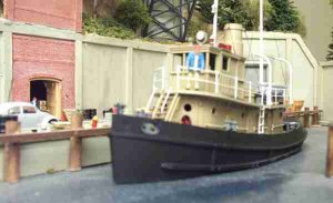

I still haven't decided what the color scheme will be. I'm thinking maybe black hull, gray decks, green bulkheads, and white trim. That may change at a moment's notice.

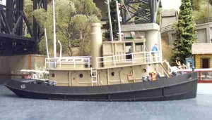

Has it been that long?!! Had to dig a bit to find this thread, for the update.
Most of the work is done, and the paint is on. It needs window glazing, decals, fenders (truck tires along the sides), and weathering.

Nice work. Which I had a spot for one on my layout.
Noticed the box said the name of the tug was "Lucky IX(9)". Couldn't of been all that lucky...What happened to the first eight?
