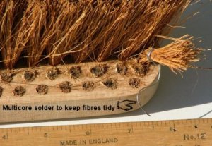

1st picture.... The broom, "getting the branches" :)
Errol

The branches
Having cut the fibres away from the broom head, you might find the full length of the fibres too long (mine would make 17 scale feet diameter trees).
As I prefer "scraggy" trees I cut the bundle in half.
Chopping a bundle of fibres into 1/8th or 1/4" lengths provides secondary branches.
Errol

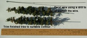

Preparing the wire
The chances are that once you cut lengths of wire they are anything but straight. Clamp one end in a vice and using a drill to twist the wire while pulling it firmly but not tight. This not only straightens the wire but also work hardens it slightly (which helps it keep it's straightness).
Bend the length of wire at it's halfway point ( use a screwdriver to form a loop at the bending point).
Clamp the loop end in a vice and slip the tape (with branches sealed on it) in between the two ends of the looped wire.
Use a drill to twist the wire until the all the branches are trapped in the wire.
You now have a bottlebrush and should trim the tree at this point (or wait till it's all finished and painted).
Errol

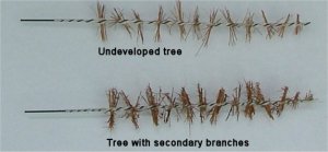

Applying secondary branches.
I find that matt Acryllic Lacquer is sticker than hair spray for this operation.
Spray the whole assembly till you see tiny globules of the lacquer on the branches and while it's still wet sprinkle the small cut secondary branches onto the assembly.
Don't get fussy about neatness as secondary branches stick to parts of the trunk. Real Pines have short branches around their trunks! Also .."leaves" will cover much of what you think is "overdone".
Errol
