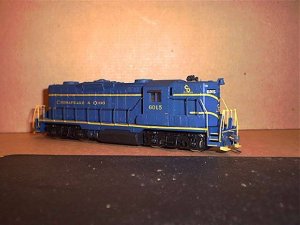

I have used the old Kemtron posts (kind of hard ti find now) and Athearn posts and >015" brass or steel wire as Russ mentioned to form the railings.

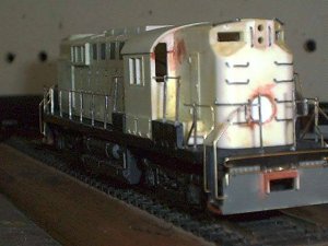

Here's an AHM GP18 with railings I made and a Model Power RS11 that I am working on.

Don
Jan 14, 2005
10
91
I've been looking for a bell like the 1 on that C&O GP. Can you give me any info about it? Never had much luck w/the SV stanchions. Found them about 3 scale "'s too short which just does'nt look right to me. Also the lip on the back did'nt fit Athearn's GP38/40 etc.
Don
Ray Marinaccio
Aug 4, 2003
1,940
65
Dewey Az.
Don,
The bell on the C&O GP is a Detail Associates bell on a scratch-built bracket. Details West makes one similar but it didn't look close enough to the C&O style.
I haven't used the SV posts. I was thinking of getting some for a few RPP shells I have. I'll have to look at a set before I order them.
