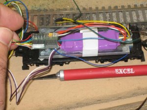

I ended up getting the Tsunami for this locomotive. Attached is the work in progress. I will be using a oval speaker about 1.4" x .8" that will be mounted facing up in the coal bunker - I'm not crazy about the idea of having a bunch of holes in the coal load, but facing it down wouldn't be very practical due to the way that Proto sets up the tender's electrical pickups. I'll be using the tender shell as the speaker enclosure.
The speaker is attached to the decoder with a 2 pin micro connector (not in this picture) from Miniatronics. The speaker will be mounted to the shell, the decoder to the chassis, so this will enable removal of the shell just by pulling the connector apart.
My initial impressions of the sound is favorable, though I only had my hand to use as an enclosure. I may have to get a new throttle to make activating all the sounds practical - I currently use a Digitrax DT100. The running characteristics with default settings are not as goood as straight DC - the locomotive was VERY smooth on DC. I'm not yet concerned about that. This is my first experience with a soundtraxx motor decoder, so I'll have to play with it a bit before forming any final opinions.

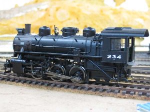

Also attached are some detail photos of the locomotive itself. I'm impressed by the backhead detail and other fine detail like the grate shakers below the firebox. The combination drawbar / electrical plug is also a pretty nifty solution and is a win in my book.
This loco will get a little extra weight when all is said and done, and eventually some weathering.

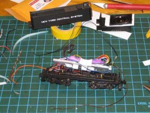

We'll see what a little tuning will do. This has been an interesting excercise in space management - I had everything packaged very nicely but found I have a clearance issue between the top of the decoder and the speaker magnet. The Tsunami is significanly larger than a motor / lights only decoder (shown is a Zimo MX61-2000 Decoder).

I can't say for sure, as I have not looked at my 0-6-0 for some time now (packed for moving) but I think that I ended up removing the stock weight, and packing new weights in the space that was left after installation...

Hmm. I'd thought about modifying the weight when trying to decide where to place the speakers, but had not thought of it for a clearance solution. I've got a little bit of relocation wiggle room with both the decoder and speaker. If that doesn't clear, I'll see what can be done with the weight. Thanks for the idea!
