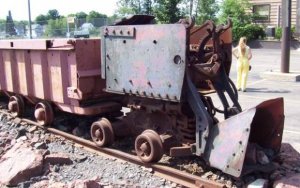

Adding something like this might make for an interesting scene,
This was used in Copper mining but the concepts the same,
Tracks laid along flat of tunnel and the sides are dre dug into at a sloping angle.Dug ore rolls down to track level,machine scoops it up and brings it to the crusher.
