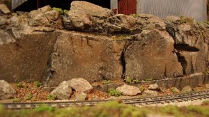

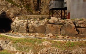

When I do rock work, I use foam, sculptamold, and even real rocks.
In these pics, the vast majority of "rock" in the close ups is foam.
I use an airbrush and acrylic paint.
I start by spraying everything black. then I spray a light coat of the darker brown (you would use your darker gray). vary the coverage and be careful not to cover over all the black. Last step is to take a natural sponge and cut a small irregular piece. dip it in the light brown/gray and dab it on a piece of newspaper or something and get the excess off so that it leaves only splatter, not smudges. Then dab it on in a random pattern, going heavier where the "rock" is raised or area you want to highlight.
If you can't airbrush...do the first two steps with a brush and the last with the sponge. I think the sponge painting raises the level of believability.
This is ONE way do it...there are many others...hope that helps or at least gives you some ideas.

Nazgul,
That is some great looking rockwork! I love the large "slab" faces - very typical of Canadian Shield. Many of the rock molds have too fine a texture, or represent sedimentary rocks.
How about a tutorial to go with the waterfall one...?!
