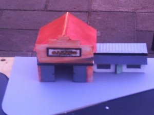

Here is the scratch built Garage/service station, that I am trying to achive the faded/peeling paint effect.(hope this works):D this is one of my first efforts at scratch building, I usualy do kits, or kit bashing. Your comments are most welcome and in fact asked for....have a good one..steve

First of all, it appears that you've got the hang of attaching pictures. Like you say, easy once you know the steps. :wave:
I would think your next step on your peeling paint would be to get an alcohol/ink wash on it to weather it a bit. I would also think that it is begging for a rusy tin roof. Nice structure, great start...:thumb:
