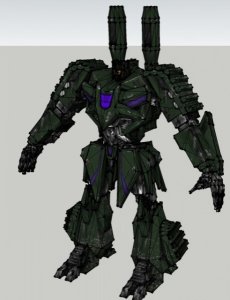

It looks easier than the soundwave to clean up.. do you think it's possible to get soundwave and the chair separate?

Ahem. Let me take a deep breath and say WHAAAAAAAAAAT? The model, the pose, the textures. It's perfect for porting to other games! How did you open the xxx archives?

I don't fancy myself a master of ripping, so I'm going to ask a few questions.
1) Is the model perfectly fixed? If yes then how?
2) How did you put the textures on the model?
3) Where did you get that pose?
Regardless, I think you should release them and make a mod.

1. Relatively fixed I would say. But certainly not ready for paper yet. A lot of cleaning to be done with loads of intersecting faces.
2. When ripping with 3D ripper all the textures was saved as DDS. I open the model and look for the reference number then open the DDS file with the same number and save it as JPG or TGA.
I do not apply the texture in 3DMax when importing the 3DR file. I export the file as 3DS preserving the texture co ordinates and then import into Meta. Then I work it from there and export again as 3DS and import it into Sketchup.
Speaking of 3D Max. I have demo / trial version on a separate PC. So each time it expires, re-store my PC and re-install Max again. Real shlep but that is just about the only thing I do with Max is import 3DR.
3. I posed the model in Sketchup by selecting the arms then rotating them. It looks good now but when you open it up in Sketchup it is messy.
I do not plan to make a mod. Don't even know how to make ragdolls / poses / bones etc etc. lol.

Blaar there's a free version of 3dmax..I think I have it's .exe file if you want but I've never used it I think its autodesk 123.Good luck!Their are double faces and such I can get them down to really simple stuff but they won't look too good.. at least I think so.

So far I haven't found any proper textures on my folders. I go to great lengths to ensure that the models I rip are as perfectly fixed as possible. I'll keep posting more models whenever I can. You could take them, put textures on them and upload the skp. How about it?
