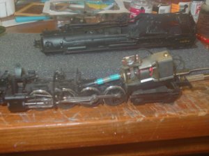

It works. Could not find fuel tube so I used heat shrink tube (see below). Works great. Vic - your right I don't need a flywheel, runs very smooth and quiet. I just might have to back date my layout now, if I can find some more Erie steam.

BTW Now that I see your photo that tubing has been replaced before. The original ones were hard black rubber.

Hi Marty, Glad the heat shrink tube worked okay, I can see the tube in the photo, should run very smooth indeed.
