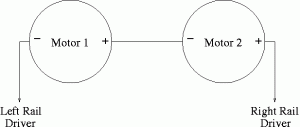

I was jest thinkin some folks might not know what series wired motors look like, so I made a drawin'. If you don't klnow which is + and which is - jest guess. If it runs the wrong way compared to other engines, you were wrong. Or I was wrong :D :D :D

And, if it blows up and sets the old homestead on fire, you'll know not to do what Jon tells you... I bet he was like my big brother when we were kids ("No really, if you jump off the roof and flap your arms, you'll fly..." "What, no I haven't tried it myself, but it works on paper and I wanted YOU to have the honor of being first...").:D :p :rolleyes: :eek:
Actually, this IS the correct way, but I couldn't let a cheap shot go wasted...:D

Yep, I know the feeling, got those little monkeys hiding stuff from me all the time... you can get replacement motors from bach if you need one. Not the worlds most reliable motor and it wouldn't hurt to have a spare if you buy one then find the old one. Running the two in series should reduce failure rate big time.
