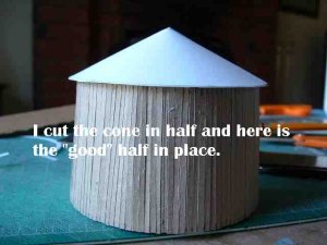

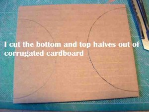

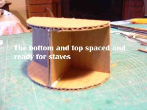

OK I just don't have room on the Georgetown Sub to put a full size water tank near the loco servicing area so I am going with a half one which goes against the backdrop. I hope when you look at it that the eye will trick you into believing that it is all there. Much like the Georgetown staion I built which is only partial too.
The tank in question is a 50,000 gallon tank and saw use on the Texas & New Orleans portion of the Southern Pacific. It was not a standard A.R.E.A. design but had a character of it'sown in that the bottom was of greater diameter than the top. I have based mine on the drawings in the April 1963 Model Railroader.
Here is my progress so far. This model is HO The bottom is a scale 25 feet in diameter and the top is 22.4 feet in diameter.
More to come.

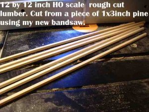

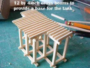

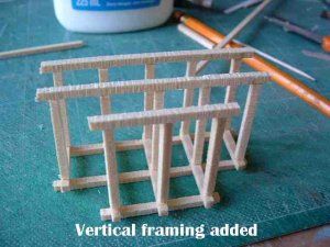

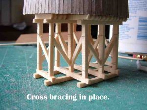

Half of the support framming
Thanks for the kind comments folks.
The support framing is mainly 12 by 12 inch rough cut lumber. My new bandsaw came in handy for this.

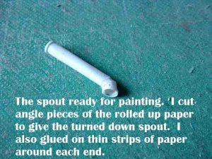

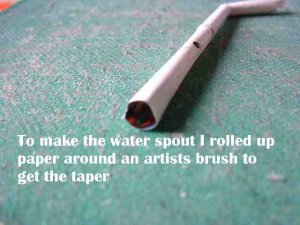

A little bit of progress today. It took me a while to figure out how I could make the tapered water spout.
