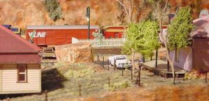

I usually paint the area with white glue first. then sprinkle the stuff on, using different mixed colours and textures. I then "drip" a 50/50 whiteglue water mix over it, and just about flood it.
I then get a mist sprayer and mist it with water all over. It looks like a blizzard flood has hit the joint when I'm finished, but the next moring? Dried. Looks good and "fluffy" and sets like a rock.
I don't "press" it down at all.
