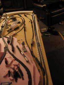

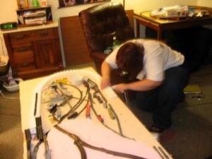

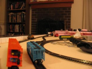

heres the pics of the styrofoam mountain under construction.
After this I'm going to figure out the viaducts and set up the upper loop.
then we start placing roadbed & ballast!
Heres the mountain area!

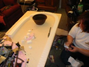

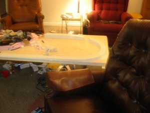

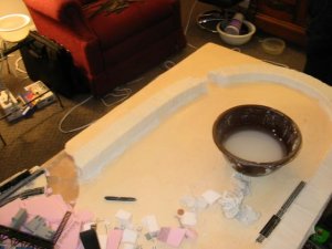

Update!
well, I haven't posted any new pics in several days, but there is an update underway:
I'm dumping all but 1 of the Piers. Because it holds them together, 1 pier will be holdimg the double-length bridge together, but the rest are being replaced with a woodland scenics incline.
I need to get the plaster cloth to cover the incline, some low-temp glue to fasten it down, and I should have that done by the end of the weekend.
Once that's done, I can stay laying roadbed, and once that is done I can get the messy stuff out of the living room :)
as it is, with the mountain and the long incline, the entire back side of the layout is not immediately visible, allowing break up of the racetrack.
Meanwhile, I've got temporary names for places on the layout:
'Bowl City' -- the city area
'Five Bridge Pass' -- the spot where all those bridges meet
'Spaghetti Junction' -- the switching area

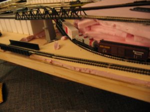

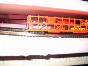

Slight adjustment
after a talk in chat about how 'no-one would make that curve'' that entered the second turnbout, I made the industry section much straighter

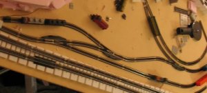

Jun 30, 2003
678
53
Raleigh, NC

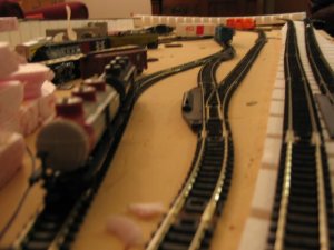

and the second!
the second layer.
The bit of track that has some stains on it are the two units that have a terminal joiner *inside* the 'bowl' -- they had to stay so the wire could run underneath. I'll roadbed this region tomorrow afternoon, after the track cures. the bit of track will have a 'bright boy' treatment
