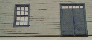

Here's the first, really fake-looking try. It just does not present well at all...essentially, it's slopped on paint, and looks like it.
By golly, I'm going to figure this out. I have so many windows that need to be presented in all sorts of different conditions.
I will update with ideas.

I think it looks pretty good, although maybe somewhat "new" considering the look you were going for. I really like the warped and uneven siding though! :)
As you pointed out, it is good to have different windows in different states of (dis)repair. There are some interesting barns in my area that are weathered completely differently on each side simply because of prevailing weather. One side looks new, the other 100+ years old...
