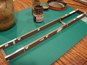

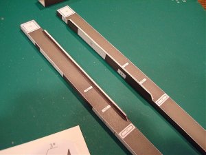

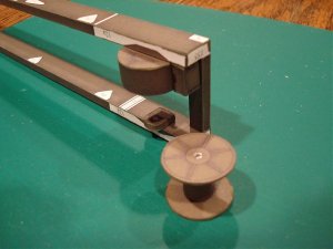

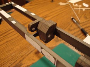

OK - Here we go!

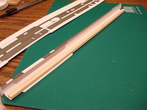

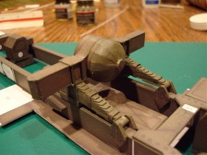

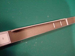

The model calls for .5 mm cardboard underneath the frame parts. But I couldn't figure out how to minimize the resulting corners. So I embedded pieces of balsa wood inside the frame rails instead. But this created a gap between the flanges (see picture 3). This was filled with 1/2 mm cardboard (picture 4).
Also, I finally nailed down the correct color (I think). Research on the Internet revealed that there are so many variants of the color during the WWII years. Then there is the "fading" effect. Even the manufacturers of model paint are different. With the help of a non-colorblind friend, I settled on a mix of 2 parts Green Drab (FS34086) to 1 part Faded Olive Drab (no FS No.). What you see in the last picture is the result. The world's worst critic (my wife) says it looks good. I am going to run with that.
Ken

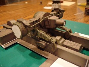

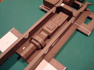

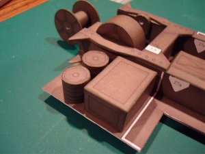

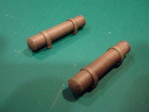

I made a little progress on the Dragon Wagon.
Picture 1 - Shows the front winch. I will attach the spool later.

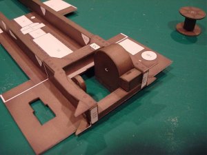

Picture 2 - The cab floor and frame reinforcements
Picture 3 - The engine/transmission
Picture 4 - The air filters
Ken

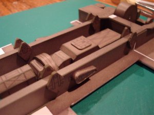

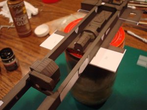

More progress:
Pictures 1 and 2 - Transfer case

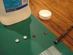

Picture 3 - The endcaps for the air brake reservoirs (I believe). Per Charliec's recommendation, I tried the "soak in alcohol" method of softening the paper to aid in bending the paper in 2 directions. IT WORKS! The endcaps are round without slits. Note that I ground the end of a drill bit to acquire the shape I needed.
Picture 4 - The tanks themselves.
Picture 5 - The shock absorbers and the front leaf springs mounts.
Next: The leaf springs.

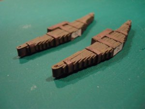

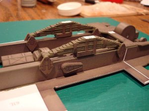

The leaf springs are straight forward as far as the build goes, but they are tricky in a different sense. The English instructions state to glue the leafs to thin cardboard, but neglected to say how thick. The selection of cardboard is critical since the vertical dimension from the spring mounting eyes (on the ends) to the bottom face of the axle mount must be accurate. This is so the vehicle won't sag or stand too tall in the front.
My springs do not take on an arc shape since I used slightly too thick cardboard, but the aformentioned dimension is correct, so the vehicle will sit properly.

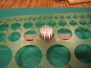

And now: The front Axle.

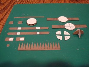

Picture 1 - The pieces that make up the axle.
Picture 2 - The main axle with the front gear cover (before shaping).

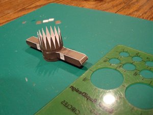

Picture 3 - The technique that I use to form spherical parts from petals. I just fill the inside of the petals with lots of glue, then use a drafting hole template - using progressively smaller and smaller holes until the part is formed. Works really great!
Picture 4 - I used white tacky glue to fill low petals - also used plastic sprues to make the spring perch bolts.
Ready to paint.
Ken
