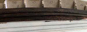

Thank you boys. I would like to represent some wear and tear but shouldn´t it be more uniform and not so rought, for the paint of the ship?

So painting technique seems to be fine, but I am still thinking about the colour of the paint.

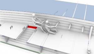

Little progress with modeling. Some historian said to me it is possible that rowers sat on deck beams, not on the chests, so I did some tests to see in what position rows would be to the rowers. It looks like realistic option. All functional replicas I know of use chests for rowers to sit on, so it is probably more ergonomic.

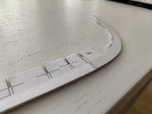

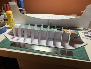

Hi friends finaly cutting some paper. This time I do not use waterbased glue for the frame and laminating. I will use it later on planking.

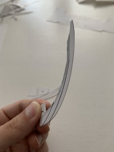

Because the keel and stems have variable thicknes I did inner structure by layering the paper.
then I covered it by skin layer:
I scribed the edge carvings by scribing tool I made from needles:

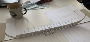

Now I am cutting the ribs. After this I will finaly assemble the frame:
And one realy great achievemnt you can see in the photos - I cleaned up my workspace. If not you, my wife will surely appreciate that :)

Journey continues.

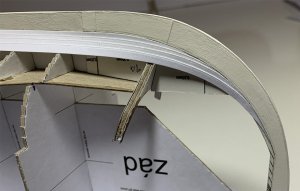

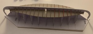

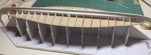

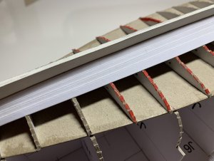

ribs attached to the keel:
All fixed and sqared with false deck:
Visible ribs assembled and carvings made. Then testpainted to see if carvings will be visible.
Jig designed and assembled and ship attached to it. Now I am read for planking:

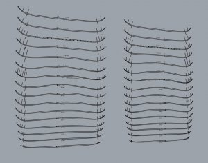

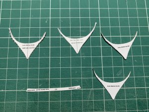

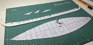

Plank templates ready to be printed:

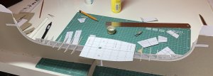

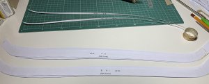

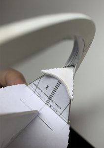

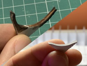

Planking journey has started, first plank in place, fits perfectly:
Here are planks in two stages of making proces. Laminated templates and cut out planks. Planks are laminated to desired thickness in a way that ends are roughly two times thinner than the middle part, same as the original planks. Also not every plank has the same thickness. In this scale differences are few tenths od millimeter, so I hope it will be at least felt if not noticeable on the model.:)
