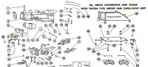

Dave if you noticed my avatar is a gilbert 0-6-0. their are no resistors on this model. Here is a exploded diagram.
frank

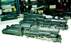

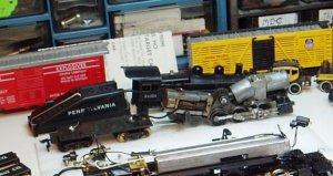

The top shows a 433 with a tyco pilot.
the bottom a open 0-6-0 drive.
I hope this helps
frank

Frank,
So... I am a newbie and know next to nothing... Is the smoke box front the round cap that would fit on to the nose? :confused:( Part #2). Do you have a spare? I'm also missing part #5... can you explain what parts #11/12/13 are?
Thanks for the pic's and the exploded view... It looks like I have 95% of the components, missing screws, pins. I will see how far I can get putting it back together.
Dave
reply
Yep! Two is the boiler smoke box front. Those other numbers make up the smoke unit, piston, and piston operating arm. And I don't have a spare for #2. That, #1 the smoke stack insert, and #5 the front pilot seam to be the most common missing parts. The screw (#32 ) that holds on the front pilot also holds on the loco body. Damaged front pilots are common also. The smoke units if not servised in a long time have their pistons sieze. I had to fix this three times. The piston is made of bake-o-lite. and so it is brittle and must be handled carefully. That boiler front was recasted and is out their. If you search "Gilbert HO parts " you will find a site with it aviable. Otherwise ebay. I have seen them their.
