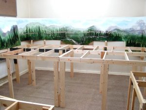

A start was made today on the baseboards for the new Badger Creek. It took all day to get the carpet clean and all the rubbish out and down the tip.
Wood arrived at 4.30pm and it's now 17.50pm and I have made one 10' by 2'-6" frame and sat it on it's legs. Tomorrow I shall build the other one and start on the side pieces over the weekend. By Monday it should be ready to lay chipboard & Insulation board, I hope.

Yoy ain't far wrong with those sound effects either, half a dozen small cuts plus a trapped foot under some B%$£y wood made my day, however, Look how far I have gotten today. All baseboards now up and just waiting for me to inlay the stilts which will raise the track 6" above the main boards.
Shamus

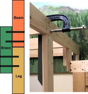

Hi Robin,
No need for angle bracing if you make the legs sit under the main board and are clamped and screwed with a brace behind.
(Won't move sideways)
In the photo, the black piece is the brace behind.
Shamus
