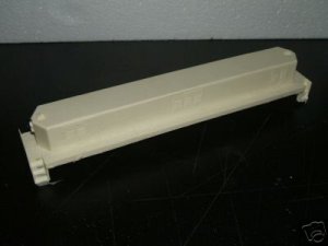

Yeah it would be about the same as the wide cab conversion I did... but different. That way would be no problem. I was just thinking about something a little different... like this picture but in a SD40-2. Ohhh btw.. that GP9-B shell is going for $45.50 + 10 shipping on ebay right now with over 6 days left on it.... :rolleyes:

That photo you attached... It's a slug.. It's different from a B-unit.
A Slug has no engine on-board.. It just provides additional traction motors that needs to be powered by a locomotive coupled to it. A B-unit is an otherwise fully-functional unit that just doesn't have a control cab.
Basically, you want to build a cabless SD40-2, right? If that's the case, you don't want to cut down the whole long hood.
I would use .020" styrene to fill in the hood sides where the cab used to be. :thumb:

Hmmm... didn't think about the differance. I believe I'll build both!!!! :thumb:
