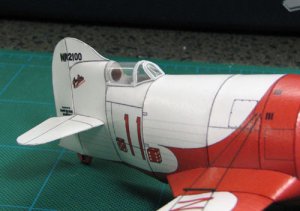

Tailwheel mounted, and on to the part I've been dreading the most, with good reason as it turns out. Canopy! @#$%!**&! (Said a lot of those tonight). From this distance it looks OK, but close up it's pretty much a disaster. In the future I'll be avoiding scratch-built canopies whenever I get the chance!

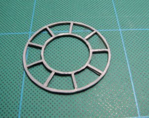

The next part is a bit tricky - the cowl support ring. It's tough because of all the thin sections that must be cut from 1mm thick laminate. To make it easier I first cut out the center and sections and then liberally coated the thing with thin CA to strengthen it before cutting out the final outside. Finally painted the whole thing flat gray.

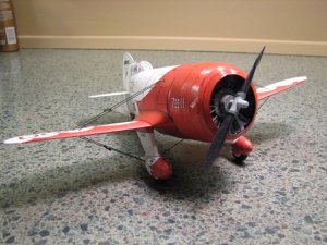

Bengt F
Nov 27, 2005
177
GeeBee R-1 Racer Finished
Beautiful work, Rick!
You really got a nice 'shiny' metal look on this one - did you spray the sheets with a glossy fixative or did you print on glossy paper?
I especially admire the work you did on the wheels with the Dremel - very nicely done!
Keep up the good work,
Bengt :grin:

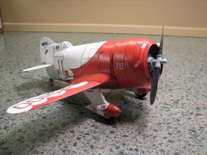

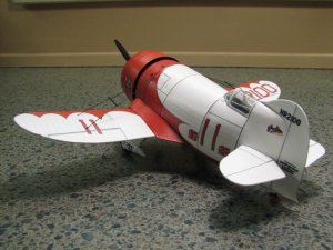

rlwhitt
Aug 25, 2006
196
61
Clemmons, NC, USA
Thanks Bengt!
Actually, I waited until it was almost done (prior to putting on the rigging) and sprayed the whole thing with Krylon gloss finish.
Rick
