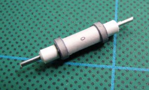

The completed rolled up part. As you see, there are card shoulders to glue the propeller blades to. This is why I don't see why the wire was needed, unless it was just to support the card being rolled, but it seems that would be strong enough on its own...

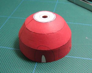

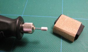

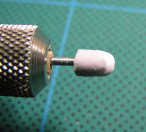

The font hub is rolled from part 23c, but it is pretty plain and squared ended as is. I sanded the part that meets the blade holders in a concave by wrapping sandpaper around a dowel and sanding it. As for the rounded front end, I tried a technique I've seen for sanding wheels. I glued the hub to the propeller shaft with CA and chucked the whole thing up into a low speed, battery operated dremel tool. Turn it on and sand with an improvised sanding block

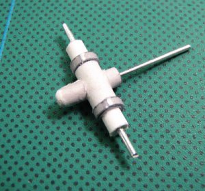

Here's the completed hub and shaft parts. Since they've had a bunch of sanding, they will need to be painted.

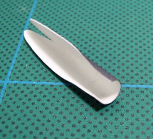

Moving along now to finish the propeller. After trying to assemble a blade with the 2 parts as given, I was never satisfied with my efforts. In an attempt to simplify things, I edited the parts PDF and created a page with a modified part. I merely slid one blade part into the other, thus creating one part, which I then partially scored for folding only on that part of the blade that would become the flat part:

Here's a revised blade part being curved at the bottom. Once glued together, I got the sooth transition I was looking for from root to flat blade.

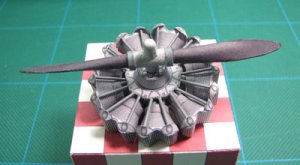

And the finished prop, modeled with the engine. BTW, this prop will be able to rotate, as it has good support front and back in the crankcase, as long as you keep the holes pretty tight. It is easy to remove and put back later once everything is assembled.

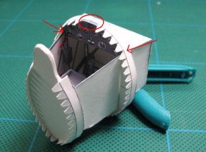

Fast forwarding a bit back to the cockpit, which now has had it's sides folded up and the 2 formers and glueing strips that enclose it put on.
Note in the pic the 2 arrows. I had to cut the former here and glue the instrument panel on separately from the rest of the former. I really don't know how it would fit otherwise. I noticed the guy on the Kartonmodell thread had to do the same.
The place at the red circle shows where I went ahead and trimmed the glue tabs off that won't be needed. I figured they'd be a lot easier to cut now than along with the cockpit opening later.
You might want to harden the edges of the holes with Future or crazy glue - I'm sure otherwise they'll wear out over time.
Cheers,
Oliver
rlwhitt
Aug 25, 2006
196
61
Clemmons, NC, USA
Thanks! I thought about that and wondered if it'd make them too "slick" and easier to fall out? But you're right about potential for wear.
Cheers,
Oliver

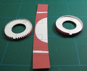

OK, time to start skinning that fuselage! I thought about putting the skin on the cockpit formers and working out from that as I've seen so many do. So I dry fit the skin and it seemed too small. What had I done wrong? I'm not sure if it's really too small or just a tight fit and it needs pulling hard. Or maybe I got the front former too big (it was a tight fit around the cockpit).
I decided I'd rather not worry about it here and possibly make a mistake that would ripple through the rest of it, so I bailed and started at the nose. Straightforward former and cone stuff here.

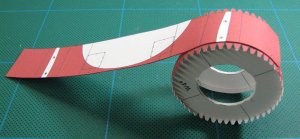

Up till now, I've followed the sequence of 1. Form cone, 2. glue in tab strip, and 3. insert former.
I got to the 4th section and it is more or less straight with strips on both sides so I rolled the glue strips around the formers first.
