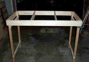

In order for me to do serious wood work, I have to move the car out of the garage, and "assemble" my "woodworking shop", so I try to get as much ready to be done as I can, in advance.
I had to build new legs for the modules I'm taking to Trainfest, so I also got the materials for the Ntrack module. Here's the Ntrack module frame, on a set of the new legs.

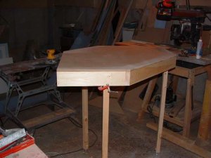

Good to see your progress Pete.
Here is where I am at with my first corner module. Adjusting the height of the legs.
Facia and backboard still to come.

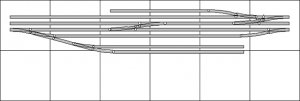

I'm getting ready to start mine - went to Home Depot today to look for stuff... founds pretty much everything that I need there. (I had to really hunt to find some lauan plywood) but found it, and it looks good... I am putting together some plans for lightweight 2' x 2' modules that I will team up to make 6'. Also, finished up the last bit of the track plan.
Things to note:
The crossovers will be #8 (but the image shows #6 - thats what was available in the software) but I have left room for them. Also, the placement of the crossover (in the center module) was intentional. Even though I have more room to "slide" it to the left, I chose not to do so, as that would put it RIGHT over the area where the modules comes apart (#8 crossovers require 16" from end to end, so even though it looks like it fits, it really doesn't - I don't feel comfortable putting it right against the edge). I wanted to put only straight sections of track on the joints (with the exception of that one curved piece - but thats a sectional track, so it should be ok).

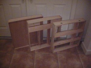

OK, been working hard on the modules. Wish I was a better carpenter, but oh well, this will have to do!
I got some plans for HO modules off the internet, modified them a little for NTRAK, and reduced it down from 2' x 4' to 2' x 2'. Then I made three of them for my full six foot module. All of my scenery will be detachable, so I can pack these in a box and send them in the belly of the plane. The structures and scenery will be carry on!
Explanation: The one on the far left is completed - just needs a layer of 3/4" foam. The one in the center is the same thing, but needs the thin "door" sheet of wood, then the foam. The one on the far right is the same as the middle, but a view from the back side. On these two, you can see the extra support where the track will go - to keep that area firm from sagging and warping.
