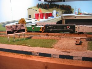

As you can tell, I am slow at updating my layout stuff. But that's about to change. I now have 6 overhead shop lamps instead of just 2. That means, I will no longer going crazy about lighting, now I can concentrate on going crazy over layout stuff.
When I last left you, I had just planted roughly 70 trees. Well, I don't have a GOOD picture of my wee forest on top of Mt. Lookatthat yet, but I will soon. This is after planting 125 more...
Here is what I do have:

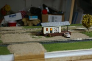

Here is a before shot of the depot:
And here it is after they graveled the parking lot:
