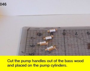

Thanks for the compliment Zathros.

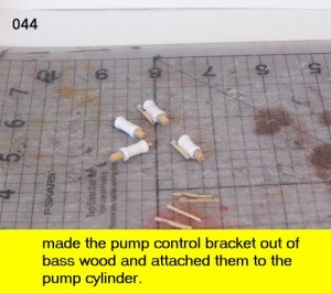

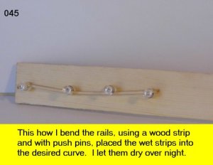

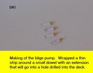

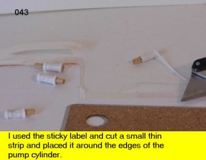

This build is turning out very interesting in the mixed media. Since I am making this a hybrid, I am not restricted to just paper in the construction. here are some more updates on the making of the pumps. There is one pick of how I bend some of the wood railings, while I am waiting for the glue to set on the pumps. Enjoy and see you all next posting.:wave:

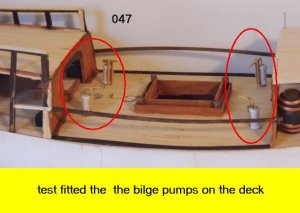

San Salvador

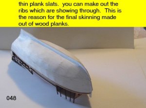

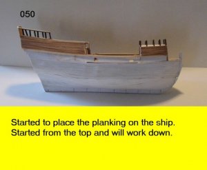

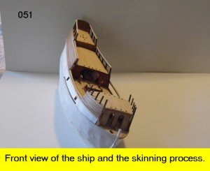

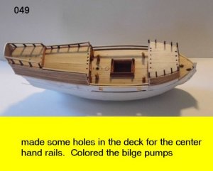

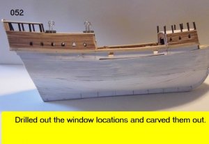

I am back with more updates on the build. The references did not show how many bilge pumps on the decks, so I went to four as noted from other Galeons. As seen on the photos, you can see the outlines of the ribs if I were to use paper planking strips. With the use of wood planking, the ribs will not show through. The windows are made by drilling the upper round arch and cutting straight down to get that window with the arch effect. Later on, there will be a trim and slats added, but I I am still working out the details for that effect. The planking is coming out great for now. I have not done the bottom hard part. That is where the fit starts to get hard, but since I made the planks thin and in scale, it will work out. I done earlier wood models and the planking was thicker. It made it hard to bend into shape, especially when the curves and bends fought against each other. The thin planking helps to overcome this fit problem. So here are the photos, enjoy and see you all next posting.:wave:

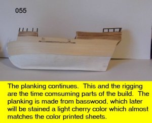

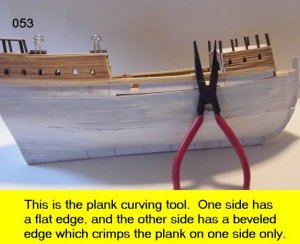

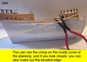

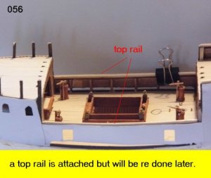

More updates on the build. It is going slow, due to the planking process. I have to wait for the glue to set before I move on to the next plankings. I am doing about 5 planking rows at a time. Here you can see the special pliers that I use to bend the planks without having to soak or steam them.

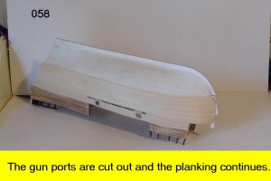

silveroxide
Aug 23, 2007
2,037
508
Fayetteville NC
San Salvador
well maintained excellent job details, congratulations
Thank you, there is a lot more to come.

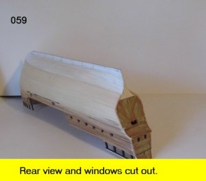

The planking is almost done and soon I can get to my favorite part, the detailing. I may have to do the keel a bit different than the usual method but that will be nxt as soon as I finish the other side of the hull. This has to be done first, so that I can clamp the keel on a base and start on the deck details. Enjoy and see you all next posting.
