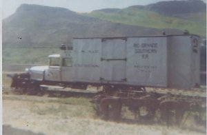

In the thirties, under receivership , the Rio Grande Southern's largest revenue source was thier mail contract, but the were not making any money by the time they paid for a locomotive crew and fuel, so they experimented with building their own motorcars from Peirce Arrow limousines, and various junkyard parts. the Geese keept the Rr in business from the 30 to the early 60's.
This is a project I started fifteen to twenty years to make a gift for my Dad. I wanted to make a goose for him. I started work from a postcard and some photos of goose #2, as I couldn't find scale drawings.
this project was re inspired by Dr Tom's efforts ( the little River RR in Dr. Tom's back yard- over in the logging mining and industrial section). and will run there soon hopefully.
For the auto body I got a kit for a Buggatti limo, made by Italiari. I had to cut down the hood, make a new radiator, and do a lot of kitbashing to the body, but I was happy with everything but an annoying splice line where the back wheel hole was filled in. Then I got a book on the geese, which showed that the original had that same splice line in almost exactly the same place. The book also had a scale drawing, and overall I had less than 6 inches of error.

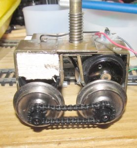

I got the goose drive set up with some miniature chain and sprockets to power the back axle off of the front one like the prototype. The first time I had it set up I had a feedback problems with the chain. the prototype didn't have that problem, as the took out the spider gears in the rear axle's differential so the right t and left rear axle were not connected directly to each other mechanically. I modified one of the sprockets on the rear axle to freewheel, so the chain turns on that side, but the whole axle is powered from the other side, and there is no feedback bind.
Next I can start putting it together and start shopping for RC stuff.

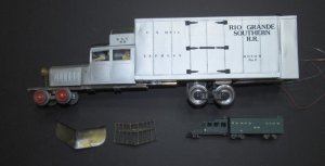

more goose parts
I have doug up some of the scratchbuilt brass parts for this critter, and I found a bad photograph of the prototype, that I own the copyright to, and can safely post,
the goose is assembled the wire leads are for testing the power truck, which will get RC some day. shown for reference is a HOn3 3 truck goose.

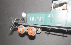

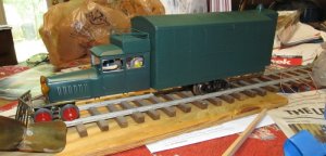

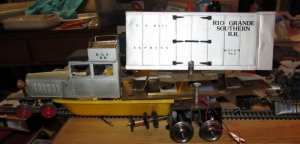

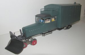

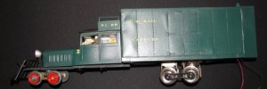

The goose has been painted green , for my private 3 foot road had it's cowcatcher and snowplow soldered on and painted, now it is ready for lettering for the state line railroad.
Now I need to start shopping for a radio and battery for it to get it ready to roll

Looking Good
The model looks great. Looking forward to seeing it polish the rails of the LRRR.

Lettering the Goose.
I got some Woodlands Scenics dry transfers and started to letter the goose. The last couple times I have used them I have had old ones that had degraded some, and it was a joy working with the new ones.
Once upon a time I had my old ones stored in my RR room, which is in the attic of a metal roofed structure. my RR room geets ho, I need to store my dry transfers in my downstairs work area, or my garage, where they won't be exposed to the heat, which after a while will make them want to stick to the backing sheet, instead of transferring to the model.
I have the letters and numbers done on the cab section, and the U S MAIL EXPRESS on the front ends of the freight body sides. I still have to do a STATELINE RAILROAD MOTOR #2 on the rear end of the freight body sides, and a 2 on the rear extension, that was added on to hold a stove to keep the mail from freezing.
the second photo shows the details on the back side of the scratchbuilt brass cow catcher and snowplow. these are some of the best brass scratchbuilding I have done. in the first photo the wrinkles in the thin styrene that had the nail heads embossed in them, and then were bonded on the thicker structural shell. The wrinkles were not intentional, but the prototype had wrinkles, so they are welcome details.
Soon I will have the lettering done I need to paint the front truck (the red wheels really have to go) and I need to get the structural parts of the power truck painted so they don't stand out like a sore thumb. Then when I get brave enough, I have to start ordering radio equipment, and hope I don't **** up too badly as I have the goose, a bachman G scale 10 wheeler, and two model boats, a Roman Bireme, and a 1860's side wheel ocean going steamer I want to put receivers In, I need to get the right transmitter.

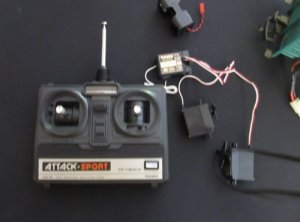

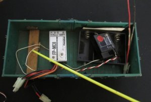

I was hunting for something in the garage, and found a box with some stuff from my Dad's old RR. Most of it was junk, but there was a 2 channel radio in there. I had one 2 channel radio, but hadn't been tempted to use it as it had a lot of corrosion in the battery area of the transmitter.
I had a radio car Dad had set up the throttle control uses a different style of plug for the receiver, so I need to splice on a different plug . I have tested the radio and it works, so when I get a compatible plug spiced on. I can start putting this stuff in the goose.
I have all the pieces except for the battery power for the motor in hand , so I can start to mount these peices, and look for a battery. I also need to look for another receiver on the same frequency, as I could use that , hooked up to another channel to run a throttle control for my Bachman G scale 10 wheeler, and run it and the goose off the same transmitter. I have a RPO car and a combine, so if I could get all that stuff rolling at once I could move a lot of mail in Tom's back yard

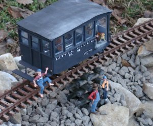

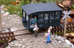

Great find. I am glad it still works. Looks like your dad was one of the pioneers in RC/Battery power for Large Scale trains.
My boys definitely need help moving the mail. Not much will fit in the Little River Motor Car #1.
In the pictures below you might be able to see the Radio Shack battery holder with 8 1.2 volt rechargeable AA batteries. It provides 9.6 volts of juice which has worked well. This was a pretty cheap set up, under $50 including the battery charger.
Unfortunately I will miss RR club tomorrow because of a Church Haiti meeting.
Tom

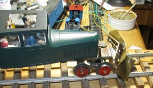

Tom, I have seen battery holder like that in fact that is what powers the goose's receiver. It would be as simple as pie to add another to power the motor.

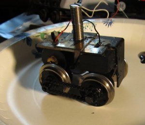

I have the goose all apart to work on gear placement Once I know where everything goes, I will need to drill and cut some holes in the frame for the transmitter's on off switch, and the motor power on and off switch. after that gets done, then I will add some more paint to the frame. I'm thinking the frame might get just a touch of red auto body primer misted in for that slightly rusty look. I think that would look good, especially at the base of the snowplow.
while I had the goose out I did some hand painting n the power truck. using some black paint to cover some brass and some balsa wood that stood out. I also painted the sides of the drive wheels black, as all that shiny nickel silver stood out too much. I didn't have power hooked up to the wheel, so I couldn't roll the wheel, so the paint job is a little uneven, but I can come in later and touch it up easily.
also today I protected what letting I have done with some dull coat. the Dull coat fogged up the windows of the cab, but I was able to use some rubbing alcohol on a Q tip to remove the dullcoat off the "Glass". The dull coat helped the look of the Krylon Hunter green. I will have to get another can, so I can disassemble the Delton Combine and RPO car someday, and cover up the Colorado Southern paint scheme in favor of a STATE LINE approved paint scheme.
