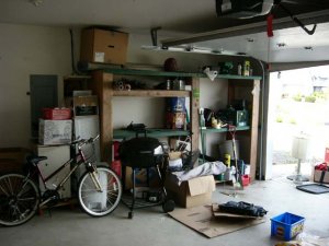

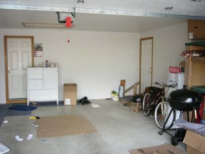

In one picture you will see two doors. The door to the left is the door into the house and on the right leads to the side yard. In between these doors, currently (these pics were taken back on the 19th and much stuff has been moved in since) reside a large shelving unit and freezer. To the right of the right side door is currently the previous owners junk that she left here :curse: but will eventually be a workdesk (not a workbench, since it's more a desk than a bench, really). Air rights above the desk are available, but take into consideration the electric panel access and cable access. These can be seen in the second picture, showing the shelving unit built in place. This monstrosity was not built by me, but whoever built it used a ping pong table, cut into 4 sections. SO, from the garage door to the cable access is 10'. From the wall to the garage door is about 26 inches.
This side of the garage is mine. The hot water heater and heat pump/AC is on the other side along with three more gorilla racks, my craftsman tool cabinet, and eventually the family car, once our stuff is sorted and unpacked, etc. I have given myself 8-9' from the garage wall on 'my' side out into the center of the room and from the garage door inward about 12-15'.
I have constructed a 5'x14" Timesaver module that I'd like to incorporate somehow. I consider access along the garage door a good thing, kinda like Bob Smaus, where his staging is fully accessible if/when the garage door is up. So planning layout all the way to the within 6" or so of the door is fine. Also, there needs to be an 'aisle' down the center of the room beneath the garage door opener where passengers will get in and out of the family car.
(Picture carrying a two year old along side Daddy's layout to put him in the car...do I really want that Alexander Coaling tower back in pieces again? 'Cause I'm sure he'd help me get it there if I needed it to be, as he grabs it, a few trees and little people along with that Jordan Miniature's truck I spent hours on, trying to get the headlights to stay on and inadvertantly drops them on the concrete floor or carrys them with him into his carseat.)
I'd love to access the layout from this side, but you may see the potential problem here.
SO, have at it. I don't have the all-in-one printer/scanner/copier hooked up yet so no drawing tonight, but perhaps later this week. For now, you get two pictures. Good luck, and may the force be with you.
The next post will contain more specific givens and druthers about the content of the layout itself.
Galen:)

After careful consideration of the space available, limitations, obstructions, ect. Also taking into account your "givens and druthers" and the vision you have for this project...I would like to offer my advice, gleaned from practical experience and considerable study of this subject:
I got nuthin'
Hope this helps:thumb: ....your friend, Steve (track planner to the Stars):D
Now to be serious...
Galen, you know I really won't be able to help much, if at all, given my short time in this hobby. But what little I can do, I will. If I can only encourage and support your effort, then that's what I'll do. Just know I, and many others, share your enthusiasm and excitement for this project (so long in coming) and can't wait to see it unfold.

Russ: Good to hear from you. I think it is standard...not exactly sure what standard is. But I know it's bigger than our rental house garage, that is, deeper and a little wider. I am getting about half. The freezer pretty much has to be in my half, along with other obstacles.

I think a standard 2 car garage is about 20 feet by 20 feet, maybe a little deeper than that. I was just confirming that it isn't a one car garage. I think it would be helpful to see a pic of it cleaned out with the freezer and modeling desk in place.

A cleaned-out space
Russ,
Indeed it would be nice to see the empty space with just the freezer and desk. Hopefully after this weekend this will be possible.
I did get a rough dimension of the room from garage door to back wall, just at 21'. With the occasional (ha) rain and snow we get up here in the Winter months (so I've heard) parking the car in the garage is pretty important. This week is supposed to be beautiful, and I've heard the wet weather really starts to set in after mid-October, so we're shooting for then to be totally cleaned out and ready to build.
Also, when shopping for a replacement dryer plug (4 prong here, 3 prong when it was installed at the rental) at Home Depot I noticed they have 2'x8' sheets of pink foam in 1" and 2" thicknesses. Lowes didn't carry it. However, there is a lumberyard in Chehalis area that has homasote...I don't want to start a great debate here, but I'm personally considering the options between a foam and homasote subroadbed/roadbed.

Galen, you might give consideration to a pulley system to lift the peninsular that is near the car up towards the roof when not in use. It would give you more access to the car, and protect the railroad from bumps when loading and unloading the car.

I was thinking in terms of the whole peninsula going up in one piece, and then lowering it on top of a set of folding saw horse type legs. You would only have the tracks at one end of the peninsula to put joiner tracks in.
