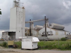

This glass factory is named after Val(Spitfire)Fullard NARA member #67. You know that I have named a lot of my buildings after NARA members.
In this case, Val posted some great photos of an existing glass factory in Brampton Ontario.
This first photo taken by Val, shows the real thing.
Next I go through a process of guess work to decide on the size and dimensions. Not easy to be accurate when working from photos and of course, available space on my layout

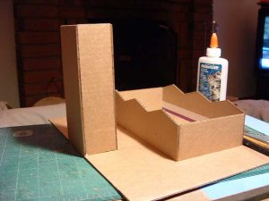

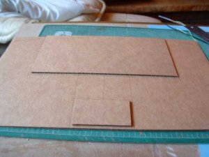

Here is the foundation of the factory. I have made it about 9inches square. This is N gauge. More photos will be posted as this project goes along.

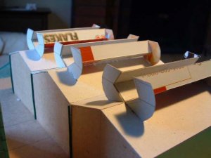

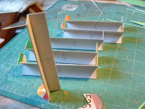

A little progress. The roof is on and some additions to the tower. Can't get the trim as small as the real thing shows and hope it will look better with a coat of paint, and yes, that's the Toronto Blue Jays losing another to the Oakland As in the background.

Originally posted by Matthyro
A little progress.... Can't get the trim as small as the real thing shows and hope it will look better with a coat of paint,
Robin,
that is one of the minor details that we have to compromise on when we model in "N". But you seem to make the details look as though they were correct anyway:) :) So we are not going to quibble:) :) :) The Glass factory looks great and the tribute to Val is most appropriate.:) :)

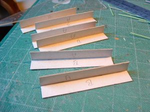

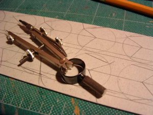

Thanks very much for your kind words and support guys. I just hope that by showing the methods I use in one step at a time will influence more folks to get into scratchbuilding.
If you look at Jon's tutorial in the archives he gives directions on starting with a photo and getting plans done so it's easy to make a model in the gauge of your choice to include on your layout.

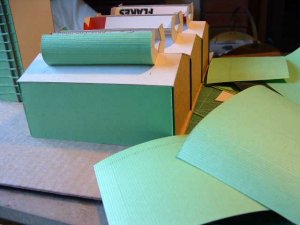

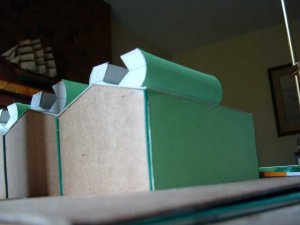

Ok now on with the model. I made 1/16 inch apart grooves with a knife on some of the bristol board I have over from making the Orient Trader. This made it easy to curve and glue to the forms on the roof.
