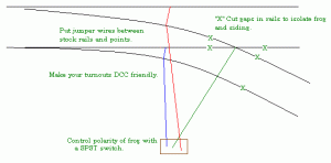

They require a 26" minimum radius. Which is really different for us On30 guys who are used to having all of our RTR stuff capable of 18" radius (And even tighter.) :curse: :curse: :curse:
You should be able to convert your turnouts so that they are DCC friendly without having to replace them.
And, the K-27 can be restricted to the mainline (Straight leg of the turnout). Or restrict the speed through the turnout. From what I have heard, they can be coaxed through some rough track if you take it easy...
Also, go over the turnout with a gauge to make sure that everything is okey.
You might be able to salvage things.
