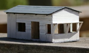

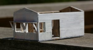

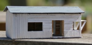

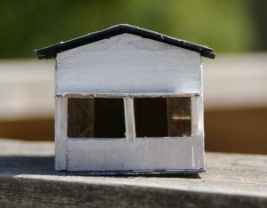

It's almost complete. I started this way back in the spring. I even took it and my tackle box of tools/balsa wood on a cruise in May.
The plans came from Railroad Model Craftsman.
Here you see the building painted white then weathered with an India Ink/alcohol wash. I am needing some guidence/assistance with the transfers from my printer. They are not coming out like I had hoped. The look too new. I have to figure out how to make them look faded and what not. I am trying on test pieces of balsa that I painted white.
Anywhoo... here are the pics. Sorry for the pic quality.

I like it! Good rustic look. It'll be great with some signs on it. I've heard of people lighting sanding the signs to make them thinner and a little worn. Perhaps some dusting with pastel chalks will dull them down as well.
Nifty little structure!

George....I like it!!!:thumb::thumb: Looks like a perfect little stand:thumb:
When you say "transfers" from your printer, do you mean signs that you printed on regular paper or some type of decal?
If paper, than I would follow Ralph's advice......you might try LIGHTLY sanding the front of the sign as well with very fine sandpaper (just enough to take a little of the ink away).
If decals...they would be applied before the weathering process.
I am assuming however, that you are talking about paper signs:winker:.
Again.....NICE WORK
KEEP IT UP!
GO NP!:thumb::winker:

Thanks for your comments. I added some balsa wood dust to the paint for the grainy look of the paint. It came out really rustic/old looking. When I sanded it down, it was too smooth and looked spanking new, so I had to do something.
With regards as to signs... I have tried both decal paper and white paper. I read about sanding the paper signs, but haven't tried that yet. As for the decal paper, I tried giving the sign a patina in photoshop before printing, but the printer still had it come out looking like a new sign. Another example of looks great on the computer screen, but printed out it looks very much different.
I will try the sanding tonight and see what happens. I think it was in the last NRMA magazine, there was an article on scraping the back of the decals with a flat razor balde... #9? ... before applying. They made it look really nice.
Anyways. Thanks for the encouragement.

.....and I like it too :thumb:. George, you did a great job. The fruit stand has the right rustic, "worn" look. I am looking forward to seeing it finished with the signs and some juicy fruits. :wave:

If decals come out looking too new, you can always weather the entire building with a thin wash of white acrylic paint thinned about 10 to 1 then dull coat it. The white won't be apparent on the signs but will tone the "newness" down quite a bit.

Looks great! I particularly like to slight 'lean' to one side, just like most of those structures did after awhile. :thumb:

Thanks again for the good reviews...
I have made some fruit from milliput, and I have thought of painting seeds, not carroway though... that's a thought, and I have made some wee boxes from scale 2x4s. I don't have enough folks to people it, but that is coming.
I have been debating lighting it from inside. since it's not solid, I am worried about light seeping thru the cracks. I have thought of building a light box, if you will, to stick inside, behind a counter or something, made of thin styrene.
As to the shape of the building sagging... well, that was a lucky break on my part, literally... When I built one side, I had messured 29 scale feet. When I built the other side, for some odd reason, it was 29 1/2 feet. When I put it together, it didnt quite look right. I showed it to a pal in the club and he "smooshed" it together for me, thus creating a sagging tilt to the whole thing. He laughed and said that was his tried and true method for over 30 years of scratch building. "Makes it haggard looking..."
