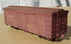

nachoman
The athearn "blue box" kits can be found readily at swap meets often for 5 bucks or less They arent as detailed as many of the new RTR models, but if you change the stirrup steps to something a little more close to scale, and swap the wheels for metal wheels, and add a little weathering, they run great and look pretty good.
Myself, i like to build my own cars out of such things as frozen pizza boxes :mrgreen:
Kevin
