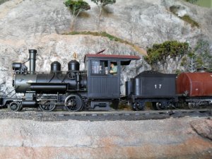

Hi Quarryman.
Sorry mate, I wasn't asking about your conversion - of course, your saddle tank is no longer a Forney!
I was asking the question about my simple little conversion. :eek:ops:
After all, as far as I know, Forneys were built in either 0-4-4 or 2-4-4 configurations, so removing the fuel bunker (and that BIG backside) and replacing it with a small tender would make it no longer of Forney wheel layout, even though the 'up front' bit remains the same.
I will post a pic, but my work is nowhere near your standards.....:cry:

Quarryman
Jun 6, 2010
50
That is very NICE !!!!
would love to see more pics of your Layout.
How about starting a Thread showing what you've done.
Cheers, Joe.

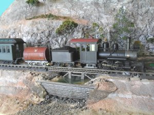

Hi Tony,
I purchased the Forney conversion kit from Backwoods Miniatures and it wasn't until it arrived that I realised that it was not designed to suit my wooden cab. :curse:
I didn't want to send it back to UK, and not wishing to see it go to waste, I just thought "Why not?" and proceeded to cut my Forney (Kate) up as per the instructions.
The job was quite straightforward, even for a bloke like me, with ten thumbs. When it came to the cab, I just removed the grab rails and the doors, and carefully cut the rear wall sections away with a razor saw.
The two rear side sections were then moved forwards to where the doors had been, and a little bit of sanding and filling hid the join.
I'm afraid that I can't supply any pics of the cab mods. as it never occurred to me to take any. :cry:
Kate's rear fuel bunker and its wheel set sat in my junk box for a few weeks before I tarted them up, and used them as a short tender for my Mogul, which now fits on my small turntable beautifully! :yep:
Kate was a lovely smooth runner before the mods, but was not especially good at sharp radii, or any dips in the track, which would usually result in the driving wheels spinning in thin air.......but since the mods, she looks great, runs like a Swiss watch, and handles all my sharp curves (15" and less) with ease.
It has made a Lady out of Forney Kate.......:mrgreen::mrgreen::mrgreen::mrgreen:
Apart from the new tender, and cab mods, the loco is pretty much standard Forney.
Here's another shot from the fireman's side......
