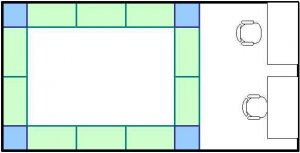

Here is a quick benchwork plan I did up. I do not know where the doors and windows, electrical plugs, or anything else is in the room. The green boxes are 2x4 modules, the blue are 2x2 corners, and the desks and chairs are "standard" to give you an idea of what a "work area" might look like.
The room is based on your first post - 24x12 feet.
Andrew
