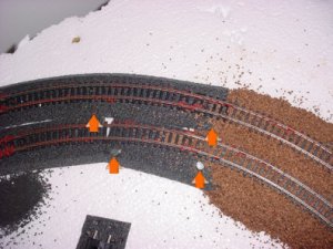

Hi Cid:
I used black taks that you can get from Walmart cheap. They work good. If you make a mistake, like I do:curse: , you can easly pull them out. When I ballast my track, the tacks stay in. The glue will harden after the ballast is laid. It becomes hard as a rock!
Where you see the arrows in this picture, are the tacks!
Andy:wave:
