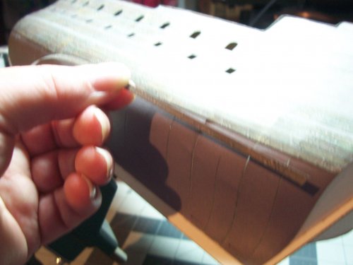

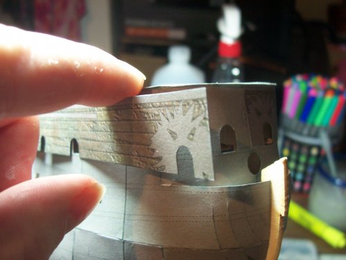

I like to paint a thin layer of white glue thinned 50/50 over the joins in the panels and then smooth them with my finger-tip to get a nicer transition. The upper-rail of the bulwarks are a bit vulnerable to getting damaged or buckled/bent during the build but, they will have another final layer over the top eventually. just be careful not to squeeze the sides during working on the model :headbange:

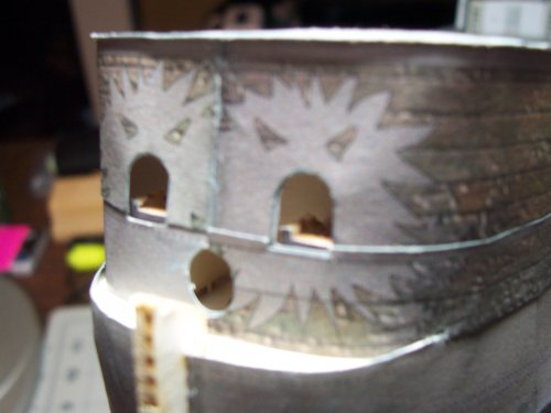

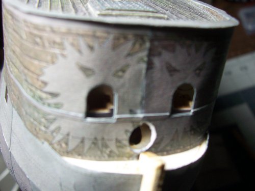

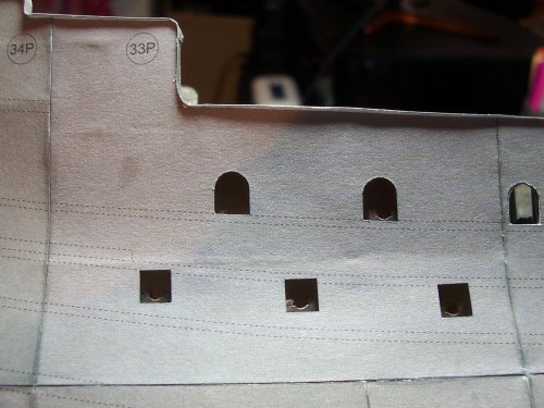

Ah yes, this is the last piece of the draft paneling for the bow area. The window ports are where the chaser cannons will protrude through... "Ah Matey!!"

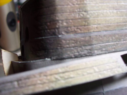

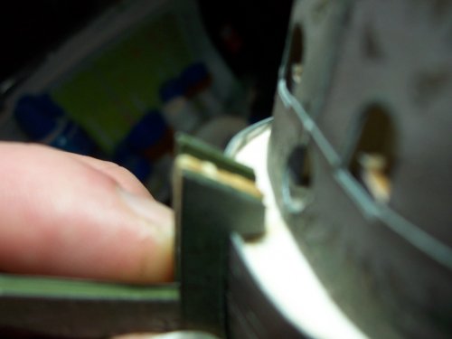

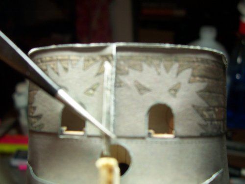

You can see that even a tiny amount of glue can cause the lip of the gunwale to tilt down, that's why I recommend using the mallest amount of white glue needed to affix the parts... you can always add a little here and there later if needed but not so easy to remove too much glue :sadno:. Wow, look at the zoomed in laser cut keel! It actually looks okay normally but pretty bumpy in the image below :eek:

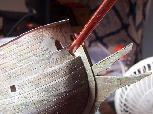

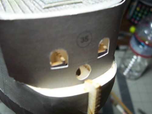

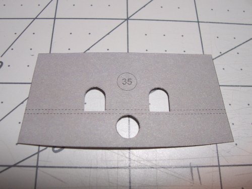

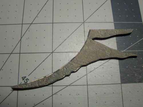

I applied a little glue to the base of the part #35 before installing it. I then used a pointer to move the base around into the correct position. The front mast will also pass through this piece eventually.

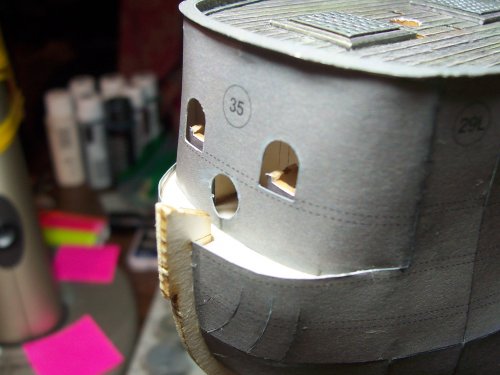

A minor imperfection in the shape of the part #35 where it joins the side panels. Easy to make a small cutout as can been seen below.

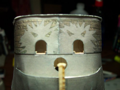

The finished draft panel work!! This is a milestone!
The shape of the hull is quite intricate with curves giving it a pleasing shape I feel. :biggrin:

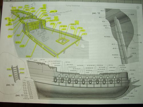

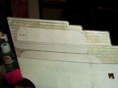

Okay, moving on to PNC (pic) 11 below. This starts the final panel work.
This is one of the sides of the final panels. There are 2 of these of curse, one for left and one for right hand sides of the ship.

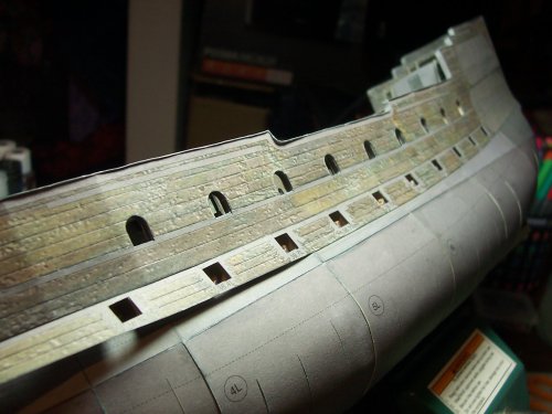

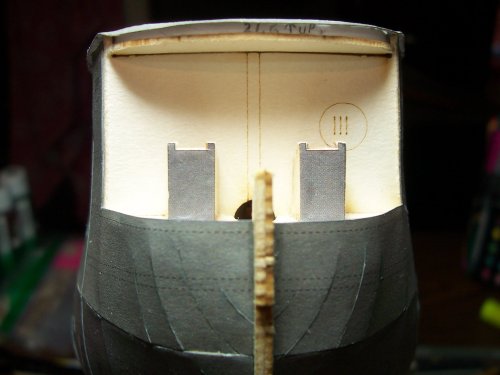

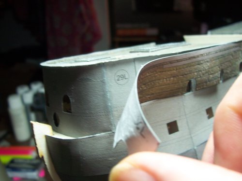

Are you ready ship's right side:? Oh and, I'm not sure why, but there are different shades of gray for the final panel pieces? A bit strange?
Minor surgery required for the join in the middle of the 2 pieces at the bow to get a really nice, close joint.

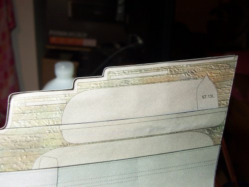

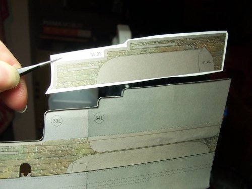

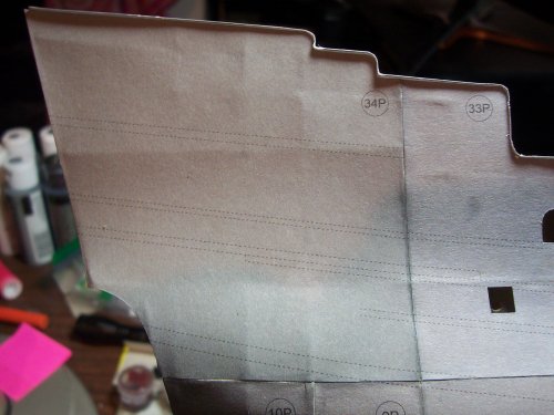

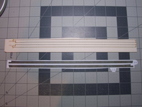

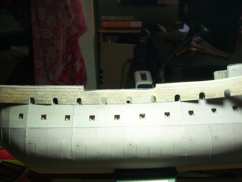

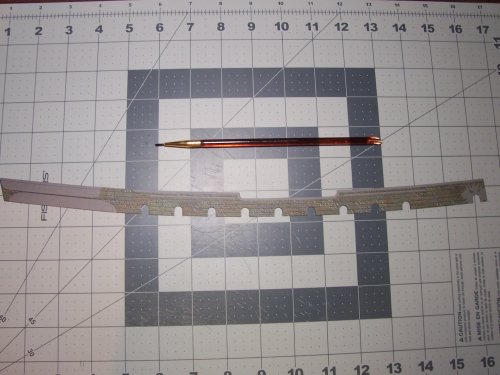

Okay, next we have the upper pieces, #36.1 L and #36.1 P accordingly. These are pretty straightforward.
All present and correct! Note the top edge is flexible still to allow further manipulation for further layers.

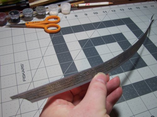

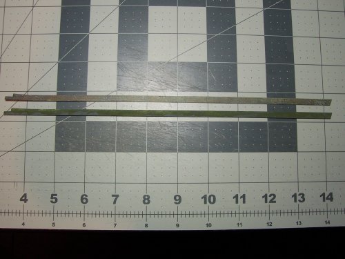

I found using a small pair of sharp scissors work the best for cutting these long narrow parts. Just cutting about 1/4" at a time super-close up, cutting "on-the-line". Take your time, and keep it nice and accurate! Also I painted all the edges, and don't forget to score the lines on the parts for the plank simulations!

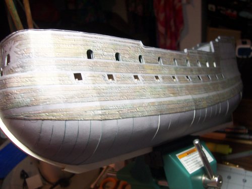

Its starting to get some really cool color on it! Its amazing how strong the hull is now becoming too :drinksmile:

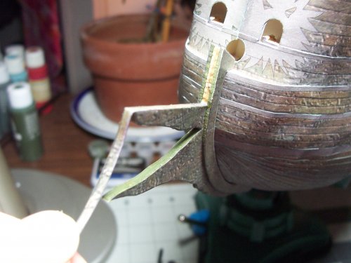

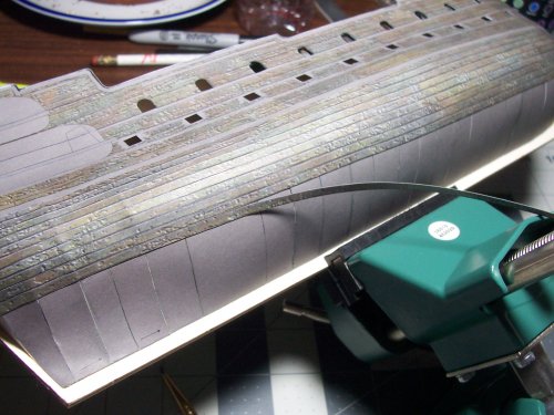

I have gathered a few tips that hopefully could be useful if you are building this model as follows:
- Be aware that most edges of the panels are not straight! and will need to be cut "free-hand" using scissors most probably.
- Photo-copy any parts that may be of risk of ruin before you start on them.
- Test-fit as many times as needed to ensure accurate fit... no really! I usually test the part about 5 -20 times as needed, and don't think it will all just work itself out eventually... believe me, it won't :triplets:
- Use packing materials for shelves of card/paper to avoid unsupported edges! Believe me, you don't want to accidentally push in one of the panels when its all finished and done :hammerhead:
- Sand until all the faces you are working with are nice and smooth for the panels which includes window frames for the cannon ports.
- Make sure you know exactly how pieces will flow together from one part to another! And how one part may affect another in the future!
- Along the same lines (forgive the pun) make sure that if there are dotted lines, that they match across multiple parts, or if they don't, you must account for that in your build work!
Thin Elmer's glue by adding drops of water to make it flow better on a brush. I use 25, 50+ percent water to glue ratio.
Glue each panel in stages, at least 2 stages starting usually at the top first, then the bottom, or even vice versa :laughrolling:

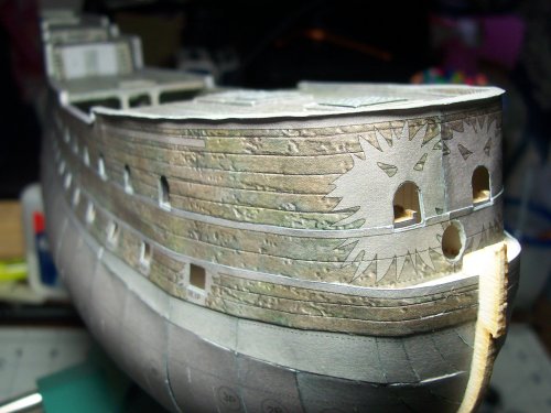

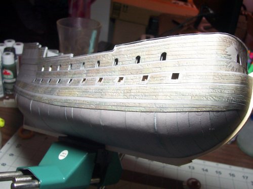

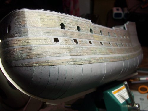

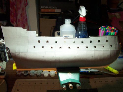

Just keep moving down the hull per the plan.

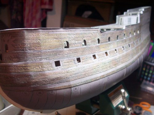

Hey, it's starting to look like a ghost ship!!

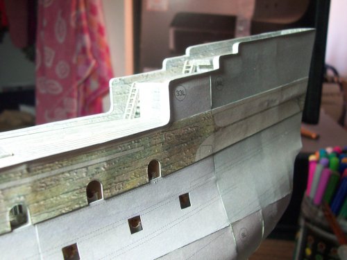

Another slight cutout needed... just a minor deal!

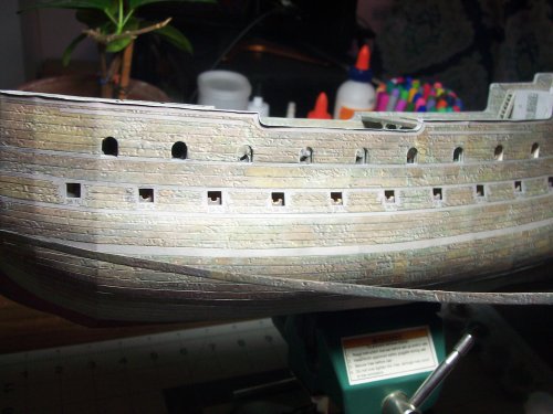

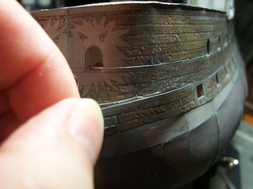

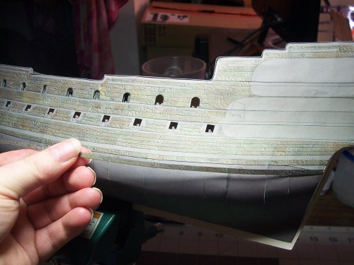

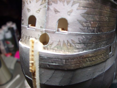

I think that the extra work of scoring for the planks of wood on the sides is worth it! Do it prior to fitting the parts if possible.
It's amazing how accurate these parts fit! These were exactly right!

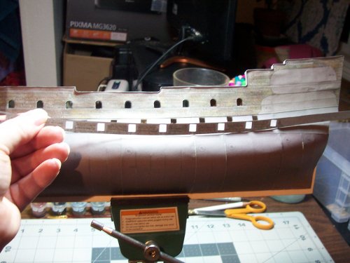

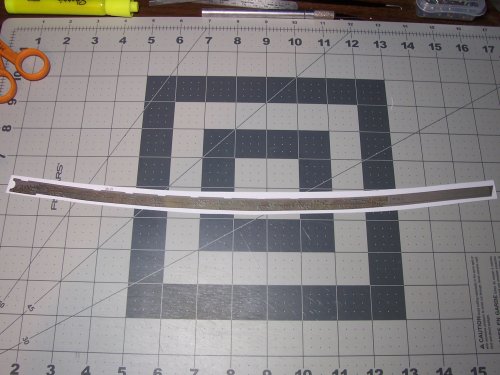

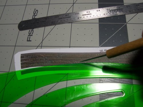

I use a French Curve to scribe the panel lines.
Ready to be installed! Remember... scribe the panel lines, paint the edges of the paper, and cut the part accurately for best results! :blueface:

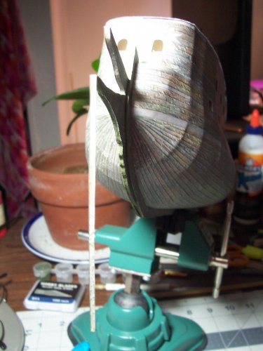

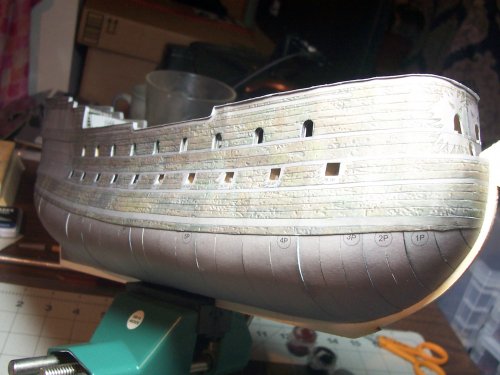

The front of this layer is also shaped in a contour. Its easier to do this before fitting the panel to the ship.
Do both the right and left versions of the same panel before moving on to the next one.
How would you do this work without a build stand? I love that thing! :smoker:

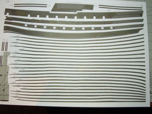

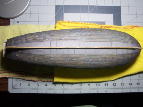

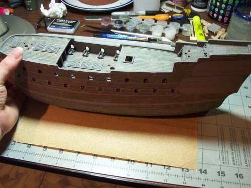

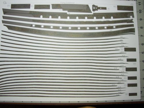

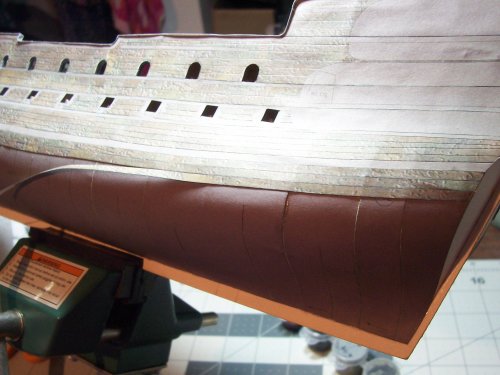

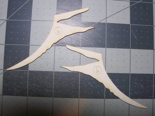

Okay, I'm back on board ship maties! Ready for another installment of the Ghost Ship build.... aaah!
Now, we start the task of adding all the planks to the hull. First of all, there's a lot of these :eek: Were talking 50 in total for both sides combined. Here's the first below.
I started from the rear of the ship. They are extremely accurate, and fit perfectly.

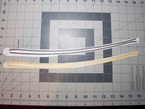

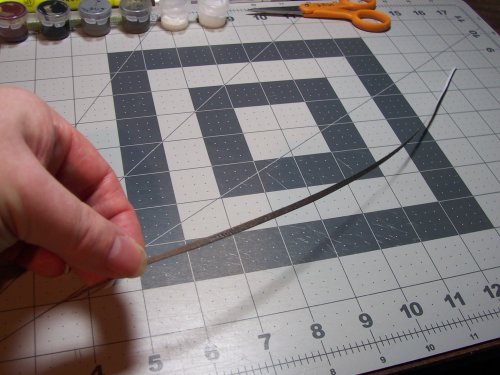

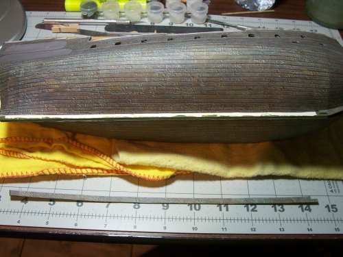

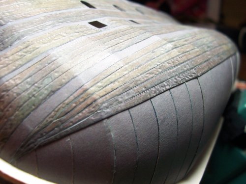

I found that the cutting of the planks is best done with a nice small sharp pair of scissors. Cutting about 1/8" to 1/4" at a time. I personally preferred to add the left side plank and then the right side all the way through the planks. That way I could ensure they line up nicely when looking from the bow cus' hey, it could finish looking like a dog's breakfast if not careful and all :yesyes::bulgeeye:
Each plank is different in shape so just be aware of that.

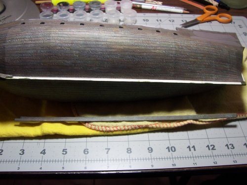

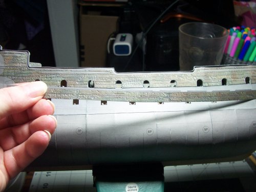

Moving right along... 2 planks per side done! This process will test the dexterity for sure! The best thing to do is to try to forget how long its taking, and concentrate on getting them looking nice. Make sure not to get them mixed up because that will surely ruin your day! :sadno:
I also painted all the edges of the plans with Pewter Gray matte paint to make the edges hidden as much as necessary.

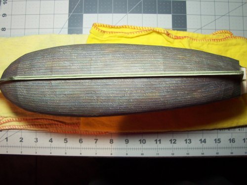

I'm not going to show every plank being fitted as that would be pretty pointless. You get the general idea!

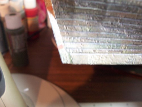

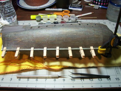

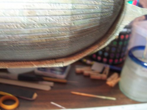

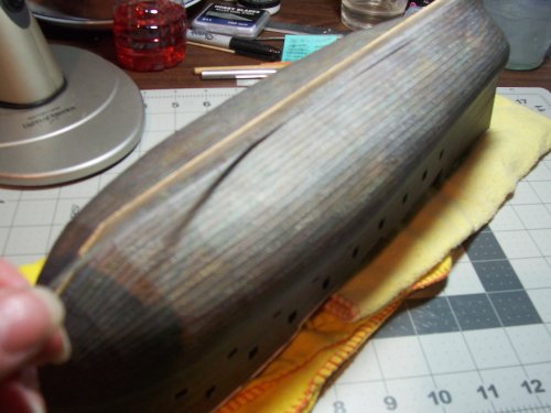

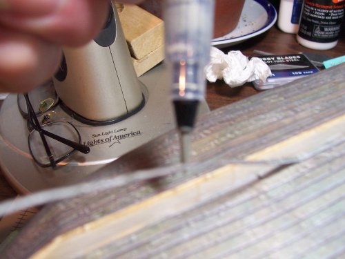

I used 25% water to glue ratio with Elmer's Glue-All. Don't attempt to apply glue to a full plank and then try sticking that thing on! That is going to finish up in a total disaster! Just do an inch at a time.
So cool the shaping of the ends of the planks I think.

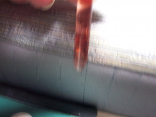

I used the angled end of my paintbrush as a smoothing tool for the planks edges.

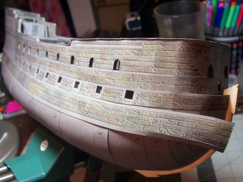

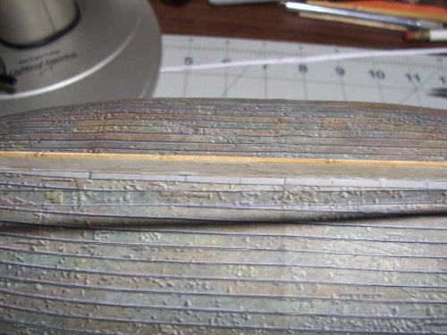

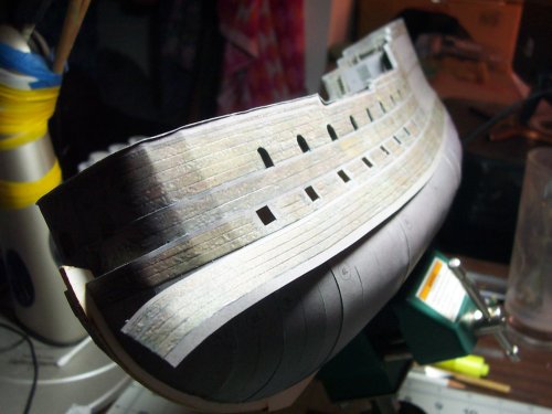

Half-way there! I used some paper and a pen to keep a track of the current plank under installation.

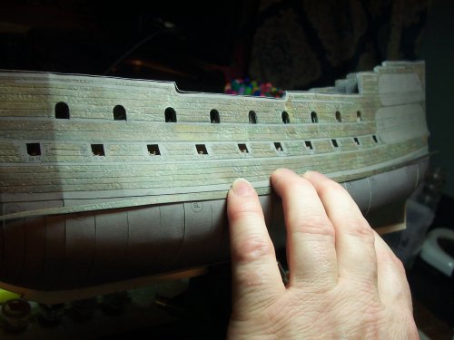

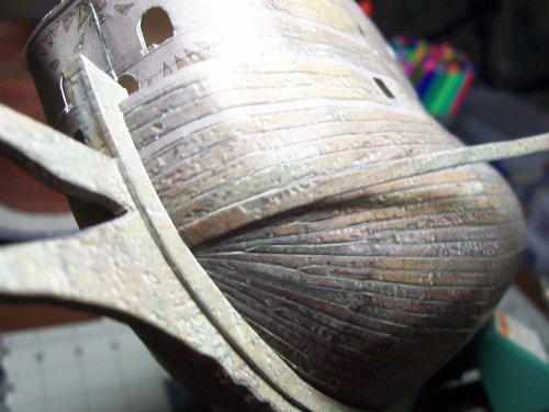

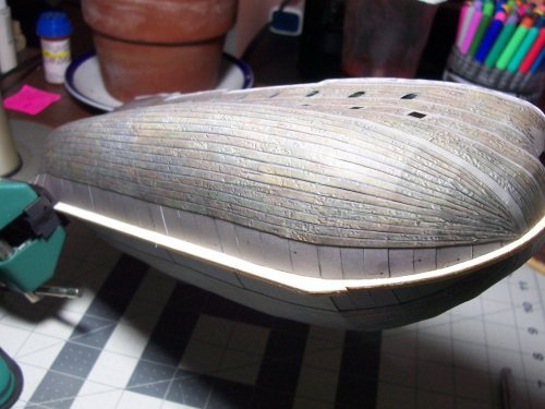

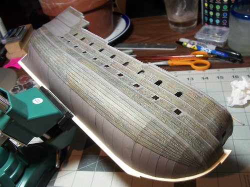

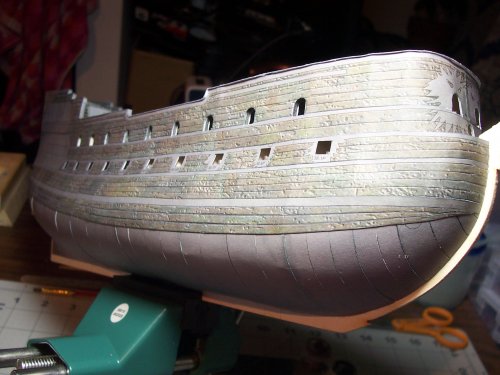

Getting close to done with the planking. Make sure to push the planks together too! As close as possible!

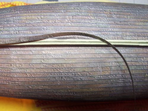

Getting to the last plank, which will be a little more challenging trying to make a nice fit.
Here we go! Last plank in process!

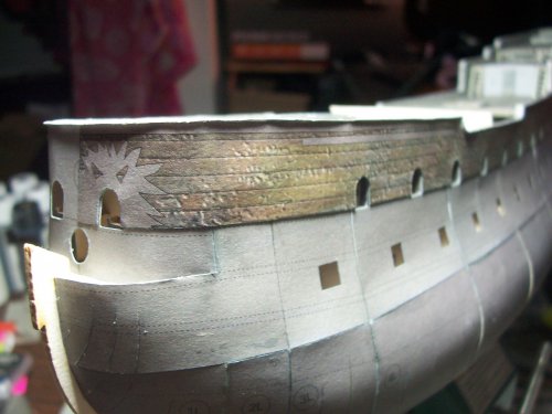

I use a Aqua-Flo brush filled with Pewter Gray paint for all the edges. It works really good for the job.

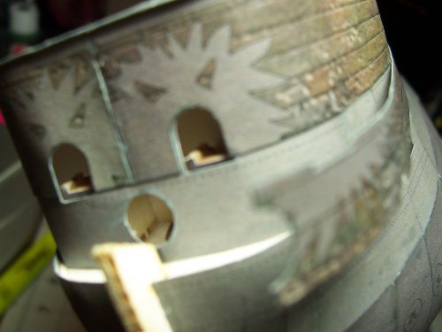

Time to work on the ship's prow! This is the bit that sticks out from the front :biggrin:

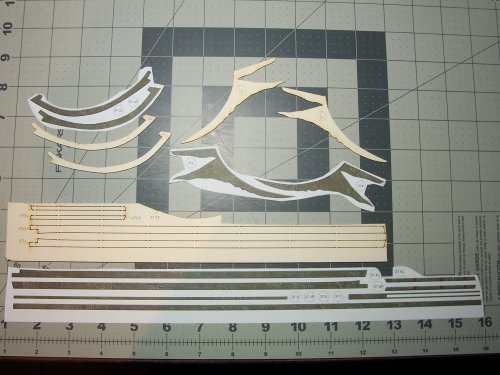

These are the card pieces that will need to be glued together.
Card pieces have been attached to one-another. Now the color veneers will need to be cut-out and attached.

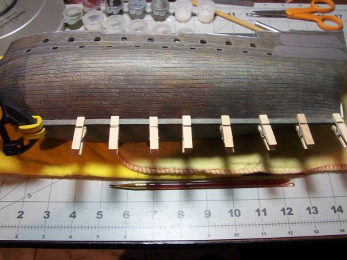

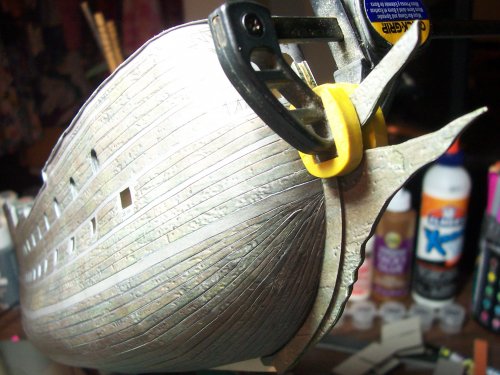

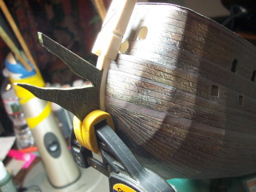

Clamped in place for the glue to dry nicely. Make sure it looks true as far as the angle is concerned by looking along the model from various angles.

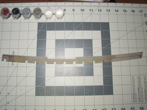

Next, there are the reinforcement side pieces for the prow.
As can be seen, there is a little work to do to make the parts it accurately.

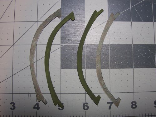

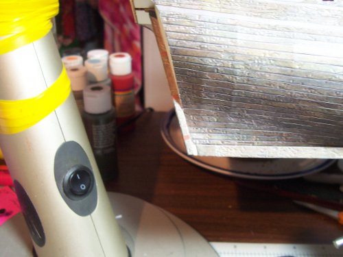

Make sure to install it accurately as regards the hinge markings in red. As can be seen, here was a slight gap where the keel longerons were not quite long enough. Later on, I added some small packing pieces to make it look nicer
Packing pieces in place and they are also painted and covered with a scrap of leftover colored paper to match the ship.

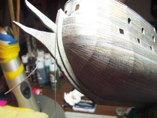

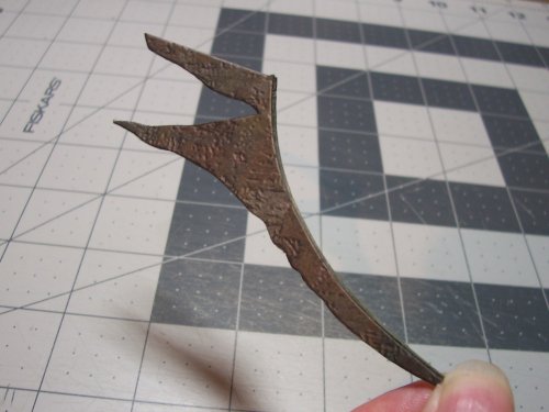

Another color veneer piece that will be attached to the bow area to hide the sandwiched joint area. Again, I just used scissors to cut the whole piece out to avoid the scalpel railroading off the straight path needed.

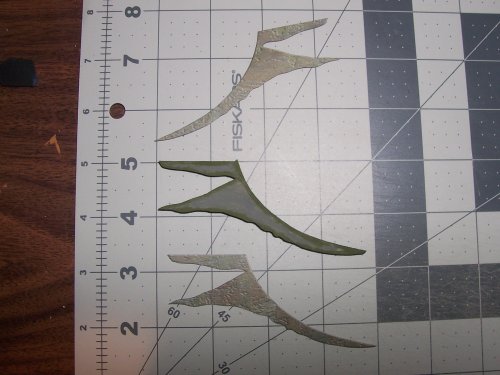

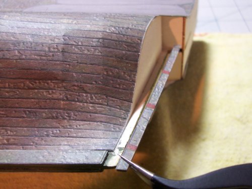

This color veneer will cover the prow's edge. The prow kind of looks like "Rhinoceros" beetles protrusion at the front... maybe?
The color veneer being installed on the edge of the prow.

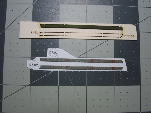

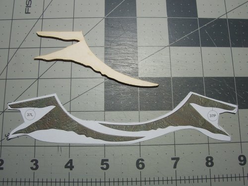

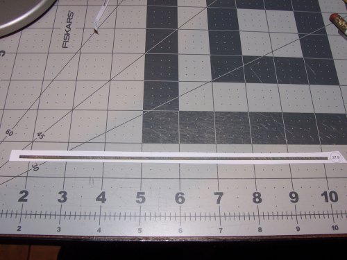

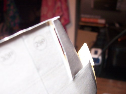

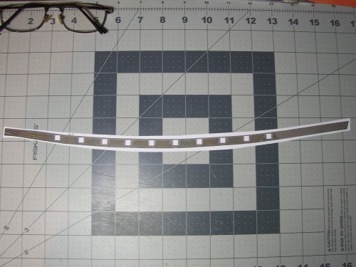

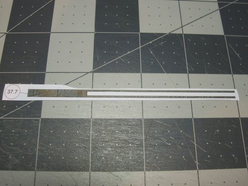

Part #37.7 is not a great fit. You will need to re-bend the creases and trim the end to fit the mast-support area.
I used my paintbrush which just so happened to be the right diameter to test for the mast installation. I did have to trim the angled supporting area a little bit before I added the part #37.7 over the top of it.

Now this is the color veneer layer that will hide the joint of all the keel parts.
I attached a sheet of 200 Grade sandpaper to my build table. I then held both ends of the hull "carefully" and ground the keel nice and flat. Got rid of any irregularities.
There, now that looks much better!
Time to attach the color veneer to the keel.
Moving on to parts #38 which is a whole bunch of parts!
