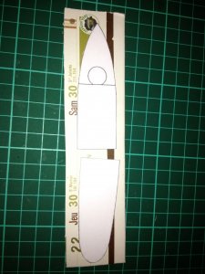

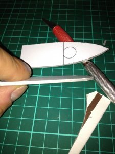

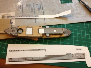

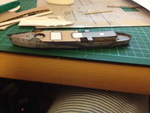

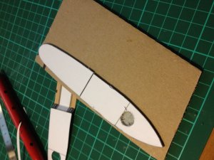

One note is that the model does not include a bottom for the hull which makes it difficult for the shape of the front half of the bottom of the hull to be nice
Another note is that I used 2 kind of cardboard to thicken the deck. One is from a calendar, bristol like, very nice but really hard to cut. the other is corrugated (I think that is the correct name) cardboard as found in brown boxes used for packing. Which is easy to cut but hard to control the thickness. None of them is satisfying

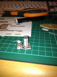

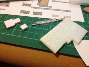

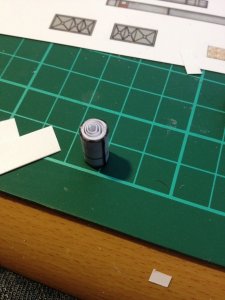

here I am working on the deckhouse and chimney. Based on the remarks above I am now using depron foam for thickening. It works much better. It can be sanded when slightly too thick and cut precisely. Also of note the technic used on the chimney to remove the tab. This was explained to me by Zathros. The step that you can see has a roll of paper same length as the chimney inserted in it. Next step I glue it to the chimney and to itself and then I have a nice thick border for gluing to the chimney top and to the roof of the deckhouse

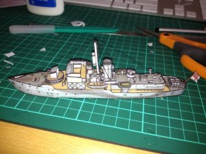

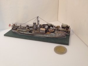

The ship is done. Compared to Olli's template I have added the rigging used to hold the radio antenna mast.
Now I have to finish the diorama

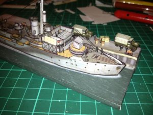

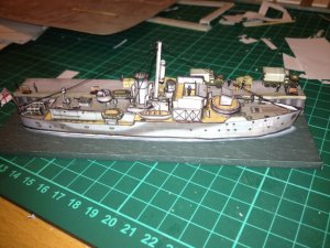

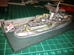

That's it the diorama is finished. I'll probably take a few better picture with a white background and some other lighting. But here are the first one direct from the cutting mat.
The effect of the whole diorama is excellent. It would be interesting to see it from different close perspective angles, with different lighting schemes. You could go from a real looking, to an anime, 3d looking series of pictures with the tweak of a few camera settings. Ollie would be proud to see this. Really nice.:thumb:
Well, you did a fantastic job, and to be honest, all your models are very well built. Do you design? If you don't, I would bet you would make a great designer. :)
