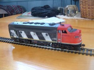

Here there should be a photo{my sandard crappy photo}of my swap-meet F,that I practice on.You can't see them all but I was doing grab irons,aside from the ones on the side,there are some on the hood,beside the front door and on either side of the front coupler.These are not "store bought"grabs but made with the wire in bread ties.What I'm really proud of is that I drilled all those holes,with a #80 then#72 bit,in a dremmel...and didn't break one!

Very neat! Great idea to practice on a cheapie and I LOVE it that you used bread tie wire to make the grab irons. They look great to me. I've used the thinnest staples I can find for roof grabs over the windshields. of some of my Fs.
Keep going, you're on to something!

i'm imressed that you used such small drilles in a dremel. I always use a pin vise and break then white frequently. maybe I should try a dremel next time.

Nachoman,I have one of those cable type extentions on the dremel,lot less weight to manipulate.I also tried a pin vice and found it awkward,would have broken bits for sure with that,and at a buck and a half a piece we don't want that.

The dremel can break the drill bits even faster, and may also turn at such a high rate as to melt delicate parts.
Unless you need clearance, the key to using a pin vise is to expose the drill bit only as much as you need. If you are drilling through 0.010" styrene, for example, you really only need to extend the bit by 1/16" or so. Also, remember to let the bit cut its way through, rather than forcing it. I usually turn the bit about 1/4 turn at a time, and then reposition my fingers on the vise.
If you can't wait and want to go faster, make sure you wear eye protection...! ;) :D
