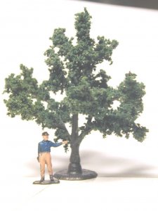

I used woodland scenics twistable plastic armatures and the ground foam that came with the kit, but I ground it finer in a coffee grinder like someone suggested here. I used a 3m spray adhesive both before, between and after dipping in the foam. I only used one of the 3 shades of green for this first attempt.
I think I will 'plant' it without using the stand.
Any critique and/or suggestions would be welcome :)

Looks good (if you remove the stand). What adhesive did you use. I know you said 3m spray, but I went to Michaels the other day and they didn't have anything that I could use, but maybe it was just out of stock (of course I didn't bother to ask :( )

Ima the trees look good (without the stand), if that's your first attempt that's outstanding! You might want to spray the trunk with a shot of dulcoat to kill the shine. :cool: Jesper around here 3M is found at hardware stores. Cheap hair spray also works and isn't near as toxic. :)
You're doing a really good job of applying the ground foam to the branches. It looks pretty darned realistic. :) And you've got the right idea when using more than one color of foam.
If the trees were mine, though, I'd be inclined to do one of two things. One would be to plant the trees without the base, as you suggested. The other would be to do some "surgery" on the base.
First, I'd use an x-Acto to cut away some of the plastic on the base so that what was left more closely resembled tree roots growing outward in various directions. Then I'd use some modeling putty to fill in the gap between the trunk and base. Carve bark texture in the putty, let it dry, and paint it to match the trunk. By the time I "planted" the tree and added some grass and weeds around the roots, the "surgery" would be unnoticeable, but the tree's overall appearance would be much improved.
You might try it with one tree and see how you like it. :)

Nice job. Looks great.
On some of the tree's I have done, I've spray painted the plastic armatures with a very dark flat gray primer. While the paint was still wet I dipped it into the foam for the first coat. After the foam application was done and dry, I put a wash of 20% black paint and 80% water on the trunk. This brings out the detail of the bark.
Marty

Aartwmich, Your trees turned out just great! ... A lot better than mine using the same kits. The secret seems to be in grinding the "foliage" finer AND using more than one colour of foam. Good thinking!
Now that I come to think of it, before I do any more, I'll try various colours on the armatures, just to add variety.

a lady forester in the works here. Nice work on all of the trees. I have to agree that the mixed color set looks the modst realistic. I Look forward to seeing your "tree farm" when you get them all planted.:) :)

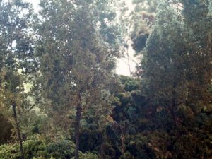

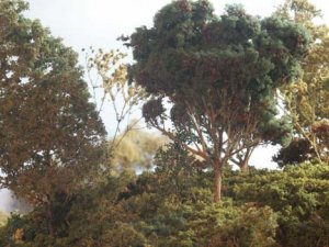

Here is another photo of some of my trees. Most are made by first spraying or dipping the trunk/limbs in matte medium and then applying ground foam of various colors. I use the darker foams first, then lighter colors on top.
Since I model the Ozarks, where various hardwoods (white oak, red oak, hickory, walnut, ash, dogwood) grow in mingled profusion, I try to "plant" a variety of tree shapes and types in any given area. I also use a lot of undergrowth and brush.
