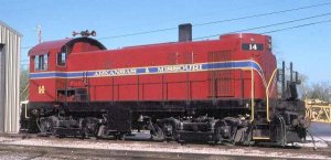

I'm planning to make a model of an Arkansas & Missouri Alco T-6. I was at the GAT Show at the Orange County Fairgrounds yesterday, and picked up S1 and Rs1 shells to start the kitbash with. I think the S1 shell may be Model Power. The Rs1 is from an old lifelike toy. I plan to use an old Athearn sw7 body for the walkways and the sw7 drive fitted with a can motor.

I don't know how to move a photo from one site to another but if you go here railroadforums.com/forum/index.php and go to the Regionals and Shortlines forum you will find a post by me titled Arkansas & Missouri request. There is a pic of the locomotive I want to model there.

From what I see in that photo, an S1 and C424 or other "century" shell would be needed, rather than the RS1 shell. I must say I have always liked those indented upper corners on the Alcos. I look forward to seeing Russ's loco.

Thanks Gary. Looking at the hood for the Rs11 on the model in comparison with the S-1 or 2 that I have, the hood on the Rs11 has a distinct "arch" at the top. The S is flat with slightly rounded corners. It would appear from the photo of the T-6 that the nose has an arch in the hood directly in front of the fan. Behind the fan the hood appears flat, and it seems to transition right in the area of the fan. Am I right?
It also appears that the end of the fuel tank is a flange mount rather than a curved corner one piece tank. The site that the t-6 #14 came from also has a pic of A & M T=6 #12 from the other side. Both pics are found on rr-fallenflags.org in the "A misc" section under Arkansas & Missouri. The Pis of # 12 shows the other side of the tank to have an even mors distinct flange end.

I cut off the front ends of both shells, and removed the grilles from the Rs11 and cut them down. I've glued the Rs11 front to the S body. The hoods matched up! I've started filling in the cracks and putting in filler pieces. I think it will come out good, if I don't screw up the details too badly.

I pulled out the Sw7 that I'm using for running boards and for a drive. I found out my first attempt was too long to fit the running boards. I started to plan a longer frame for it, but when I look at my Alco book, the overall length of the T-6 looks similar to a S. I cut off the nose and removed a bit more material. It is now just the right length for the Sw7 frame and running boards. I'm going to let the glue dry overnight before I put the cut down grilles on.
I think the model I got is an S-1 since I noticed in my Alco book that the S2 has the vertical ribs in the grille. I think the round fan in the nose may be a little close to the nose on the T-6 than it is in the Rs11, but I'm going to call it good enough. As soon as I have the grilles mounted and the spaces filled in and smoothed out, I'll try posting a pic. I'm going to need to do some radical cutting down of the frame, and I'll have to find a can motor for it because the motor in my Sw7 is one of the W-I-D-E Athearns
