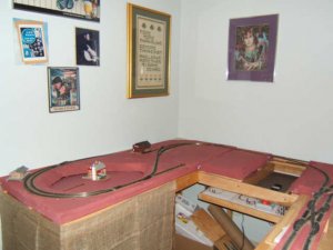

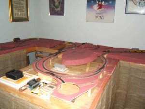

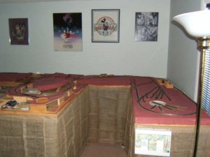

Big news, I finally bought a digital camera, a Fuji E500. :D So now I can post pictures of the progress on the CVR.
Two major things happened.
1. The benchwork now has a skirt.
2. Initial coloration of the foam makes things look better. A friend says it looks just like the red clay of the real Credit Valley. :thumb:
