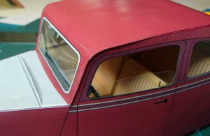

I had a little incident on my build. I was so depressed with it that I was very close to trash my work in progress and start over from the beginning... But let's go in order.

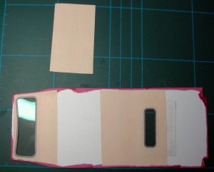

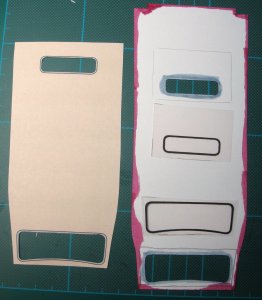

This is the heavy cardboard piece that closes the ceiling giving shape to the roof of the car.
The original piece had no color, it was not printed. I decided to paint it because it's clearly visible from the windows.

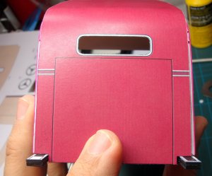

...and here is the problem. The upper bodywork piece doesn't fit with the existing sidewalls. There is more than a millimeter at every side in the rear wall and other gaps in the front part as you see.
I redraw the piece leaving something more than needed to be able to trim the excess once the part is in place (melius abundare...)
Redrawn the ceiling with the new shape.

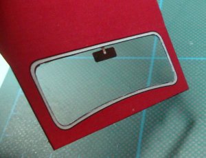

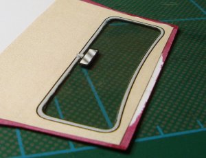

Prepared the "glass" pieces for windshield and rear window.
Prepared an inner sheet with interior colour to be glued to the underside of the ceiling.
The parts are now glued togheter.
I cut the central section (not visible under the heavy cardboard seen above) to concentrate my attention to the windows (I prefer to glue only one window at a time).

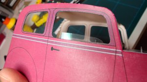

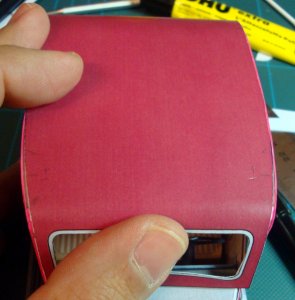

Prior to place the ceiling I glued the rearview mirror to the inside. Nice detail!

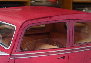

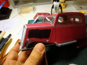

Now this edge is not flush with the side wall. I tried to cut the excess with scissors and ... TRAGEDY!!!!! The scissor blades scratched away big sections of ink from the parts.
Conclusion: NEVER USE LASER PRINTER FOR YOUR CARDMODELS ! ! ! ! I swear I'll not do it nevermore!!!
I choose laser print to have a more "glossy" look, I thought it would be better for a car.
But the laser pigment has very low "grip" on the paper. Only touching it with fingers changed the color of the bodywork.
Now the scissors have produced big white scratches.
I have ruined my car. I tried to retouch the scratches with a felt tip pen but the result is a disaster!!!
...continues...
Tonino
Apr 15, 2004
779
1,714
83
59
Republic of San Marino
www.facebook.com

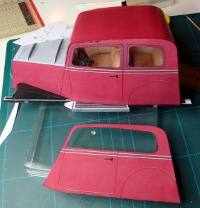

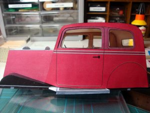

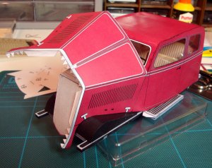

... I waited one day until I cooled off...
Now I can think to some walkaround.
I printed other copies of the side walls on thin paper (photocopy sheets) to add only little thickness
Carefully placed it over the ruin
Much better. See how the color of the old part, under the new, was changed only touching the model with fingers (see on the left).
Laser print is not reliable at all.

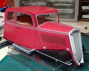

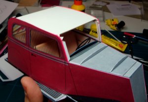

Now I can place the engine hood and start to think about the radiator grille...

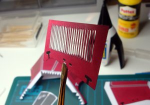

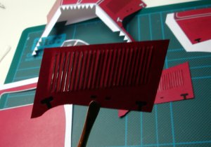

Yes RB, I considered it. Really my first thought was to cut the louver and fold outwards the paper to give it a perfect look but, after my recent ink problems... I gave up. I'm afraid I'm going to have color falling away from all the hood if I cut it the way I was planning to do.
Your question, however, re-ignited my interest on this part of the car so I wanna give it a try. I'm going to print a copy of hood side walls on thin paper, I'll print also some red on the rear side (so I won't have to use pen on it). I'll cut and fold it... and let's see what happens...

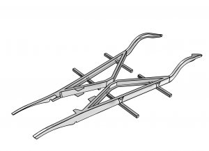

I have found a frame and under carriage for this car. It will take me around two probably much more, days to make it "construct-able", but it's all there. Keep working on what you are doing, if you body doesn't drop right down on it, it will only take a few cut on the flat bottom to make it fit. :)

If the frame is detailed enough - I'm writing as I'm thinking - it could be presented as a stand-alone subject side by side with the completed car.
Something like the situation depicted in one of the photos in your previous post:
This solution - however - should require a complete - and detailed - engine... Is your 3D model complete of engine?
And - another important question - do you have also the wheels? The ones included in this model are a little too "square" in my opinion. It would be nice to find a possible alternative.

Actually, I think you will be able to cut the frame up and glue it to the bottom! :)

You Body work is fine, we'll just adjust what is necessary for this to bolt to the frame, and YES, You and I will have created a whole new model!! :)

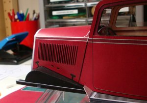

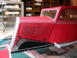

@Rhaven Blaack this is for you!
After all I couldn't ignore your suggestion...

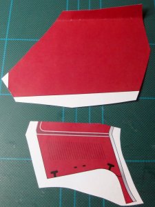

I printed a copy of the hood on thin paper
Really this is a first try.
Then I noticed slots were not aligned and misplaced.
I redraw them and printed again.
I also printed red the backside to avoid some white surface to be visible from rear.
This looks much better than the black printed louver.
A touch of black pen to the underside
And this is the new hood side in place!
:D
12,563
8,059
The louvers knock it right out of the ball park! :)
Reactions: Tonino
11,004
7,527
This is the great value of a place like this! I wouldn't ever placed my blade on that hood without RB's words.
... ... ... and, after all, I wouldn't ever started this thread without a certain gift I received... ;)
I am glad that I could be of help to you. thumbsup
I really like how this is turning out!
