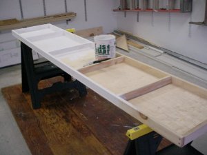

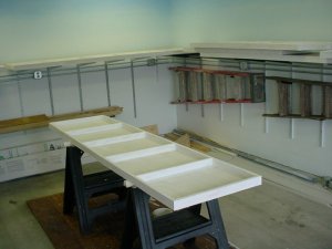

I went ahead and added all the cross bracing under the 1/4" plywood yesterday. If it ends up that a brace is exactly where a switch motor should be, I'll chop it or drill it out.
This evening, I started painting everything, using waterbased primer.

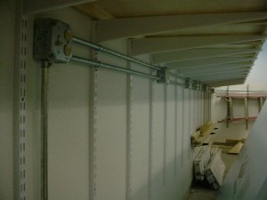

Here is the 120v AC electrical supply for the layout. The switch turns all the outlets on and off. There are 13 outlets total, will be used to plug in the digitrax power supply, the power supplies for the infrared panels for the throttles, a 12 volt DC, 7 amp supply for the switch machines, and another for the electromagnetic uncouplers.

Question. Why did you use two conduit joints between boxes?

Zedob, I was wondering if anyone would ask about the conduit. Because I mounted the conduit to the vertical shelf tracks, the boxes are about 3/8 inch away from the wall. Instead of using spacers with toggle bolts or drywall anchors to support the boxes, I am just letting the conduit support the boxes. The extra conduit is only used to keep the boxes from twisting when stuff gets plugged into the outlets. The hot and neutral are both in the lower conduit, the upper conduit is empty.
Yes, the NEC requires the boxes to be supported seperately, but in this case, the AHJ has ruled this to be acceptable. (wink)

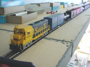

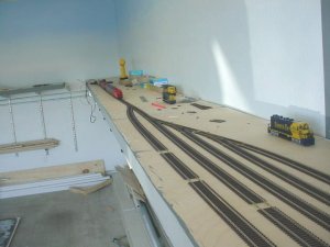

more progress:
Got all the shelves primed and painted 2 coats underneath, and am playing around with track arrangements and running some trains.... experiments.
I am just laying the track on the plywood for now, trying to come up with a good arrangement. I'll glue the 2" foam on later and get started for real.
Yall have seen pics of my shelves, if anyone has any thoughts on a layout to fit it, I'd be grateful.

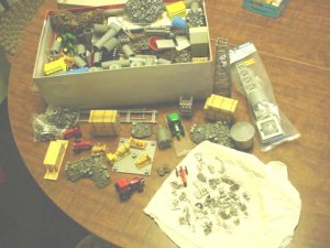

also, I went to a train show this weekend, not a real huge one but a real good one, lots of stuff for the "real" hobbiest, old engines, old structures, boxes of old cars, all that kind of interesting stuff that you don't see in the typical LHS.
I bought a big box of structure detail parts, LBPs, flat car loads, tractors, junk piles, towers, 2 flat cars, all kinds of stuff for $40 and well worth it in my estimation:

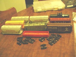

and, 9 pieces of rolling stock already equipped with metal wheels and most had kadee couplers... for on average 3 bucks each. They need some cleaning and TLC to make them fully operational, but that is half the fun!
I really like the Texas Central covered hoppers.

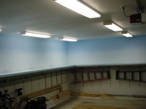

Woohoo, the blue foam stuck! Took the clamp boards off today and everything looks great. Here's a photo of one side of the room. Still have 7 more sections to do, but it's cold and damp outside today so will have to wait.

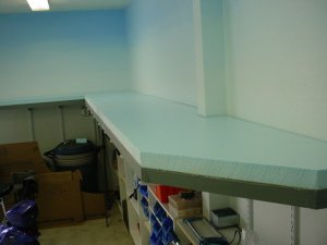

This Layout Party idea is great. I love looking at all the layouts and all of the work being accomplished. It also gives me tons of ideas. Thanks everyone! However, seeing all of the great stuff you guys are doing leaves me with the feeling that all of my plywood and blue foam is pretty boring to you guys.
But it's all a part of it, right? I'm really pleased with my progress. We had PERFECT weather down here on Sunday, I finished glueing all the foam to the shelves, and can say that the benchwork portion of my layout is COMPLETE!!!
Now to finalize the track plan and REALLY get started on making something happen.
Andrew: I had some more ideas on my layout this weekend, will get my thoughts together and post them sometime in the next few days.
